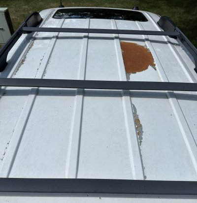

I just realized my roof is horrible but the rest of the body is clean. How bad is my roof and what is the best approach? Anything that can be done as diy or too far gone? I honestly won’t have the time or place to sand it down and much prepping. Can you just simply use some spray on it? What would happen if nothing is done? My truck unfortunately will not be garaged either
I would just clean it (sand and neutralize the rust), paint it and maybe a layer of rust reformer before the paint.
