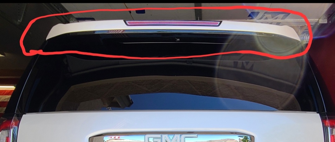

Backed into a tree and cracked this part. I want to try and find a used salvage already painted the white diamond color. Does anyone know the part number for this or have one for sale?

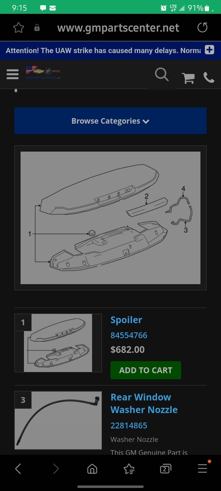

typically it's called a center high mount brake housing or 3rd brake housing
if you need a specific gm part number you can look it up by your vin or remove it and look on the backside
in any case a new one will not come painted, nor will a used one have a part number specific to your paint code.
2015-2020 should all be the same yukon, yukon xl. Denali may be different, not sure
if you can't find one in your color a shop will probably charge 200-300 to paint -to-match
