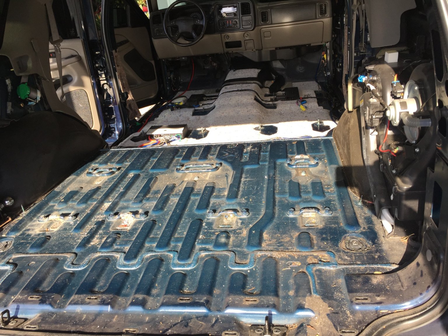

Here's what you will see behind that panel.

i haven't opened it up yet, but what would be running that is clicking? i don't have the rear ac or heat on. is there something that just constantly circulates air?
and thanks for the pic

one of the actuator is stuck or has a broken gear and keeps clicking. Probably the one that controls hot to cold.

Michael, in the picture you have provided, is that the BCM under the second row drivers side seat and is that the common place for BCMs in different years?
