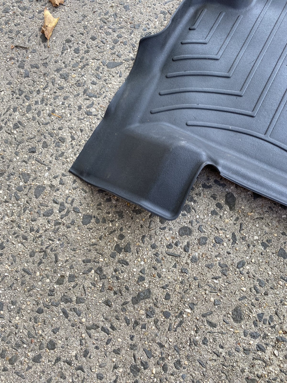

Heat gun idea was the fix. The curved areas are less rigid than the rest of the mats so I assume it’s going to come back. I don’t sit in the back so it won’t bother me as much lol

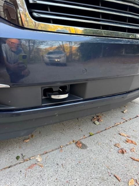

After buying my 2019 I binge read this thread. I wasn't going to do any mods, but you know how that is. Here is my first one... installed tow hooks. Not sure if I am going to reinstall my front license plate holder and drill through the new fascia. If anybody wants the old fascia for fog lights, it's free for pickup in the Dayton Cincinatti area.

Are they just the trim pieces to hold fogs?

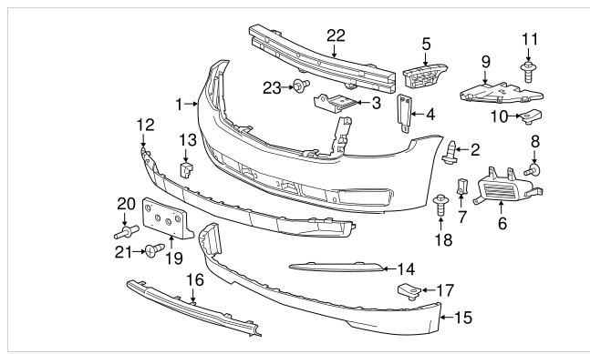

It is the plastic fascia (that black piece). Part #12 in this drawing. There are four different ones. GM has them plain, with fog lights only, with foglights and ONE tow hook (if you have adaptive cruise), and with fog lights and TWO tow hooks. I bought part number 22936496
The one I have for free local pick up has two fogs only.

i'm going to add fogs to the wifes burb eventually, but I believe hers has that piece already and the fog light area just has a plastic cover/insert.

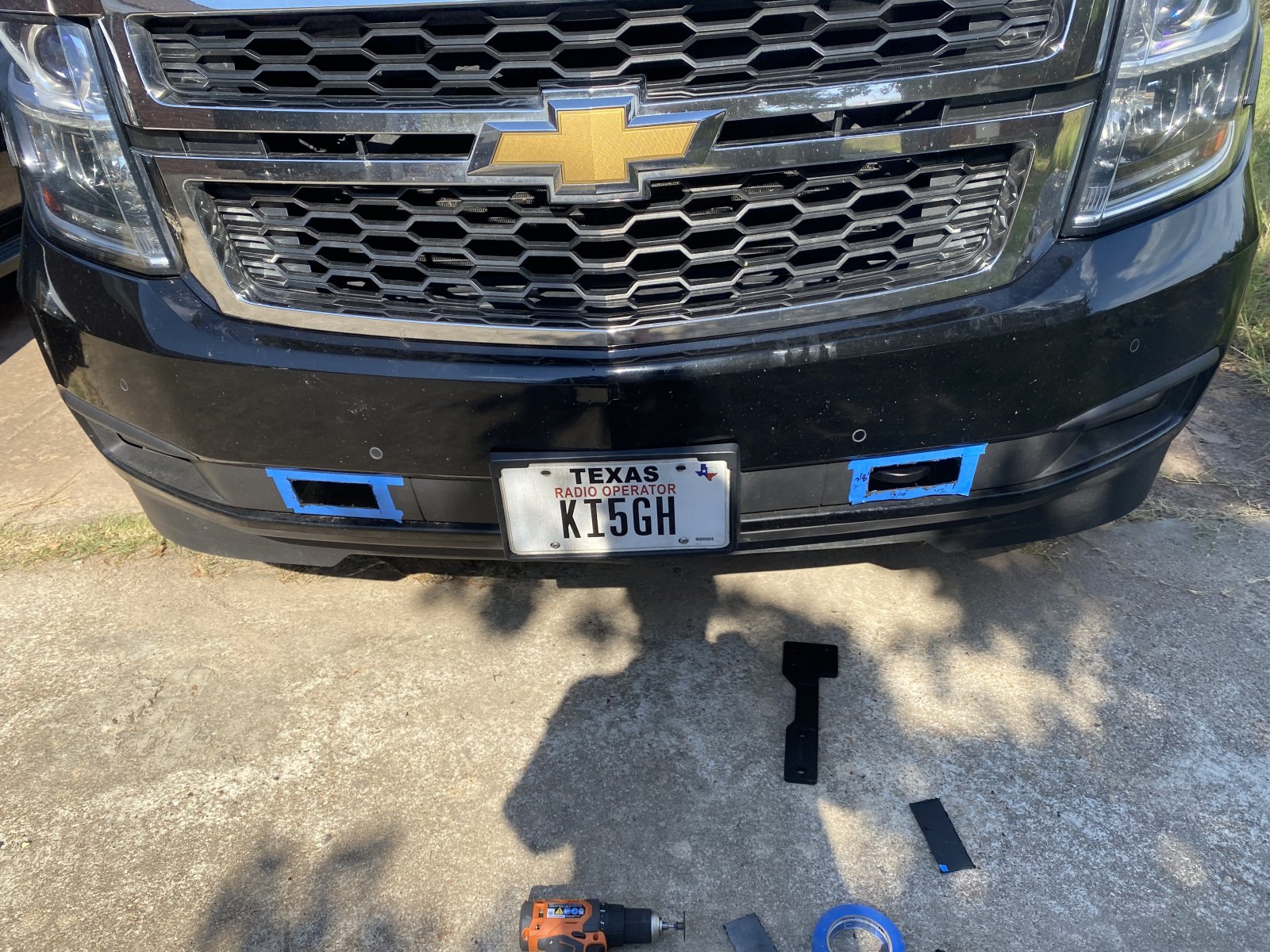

I just measured the crap out of mine then used a dremel to cut it. I also had a grander plan. The inner parking sensors also were relocated.
