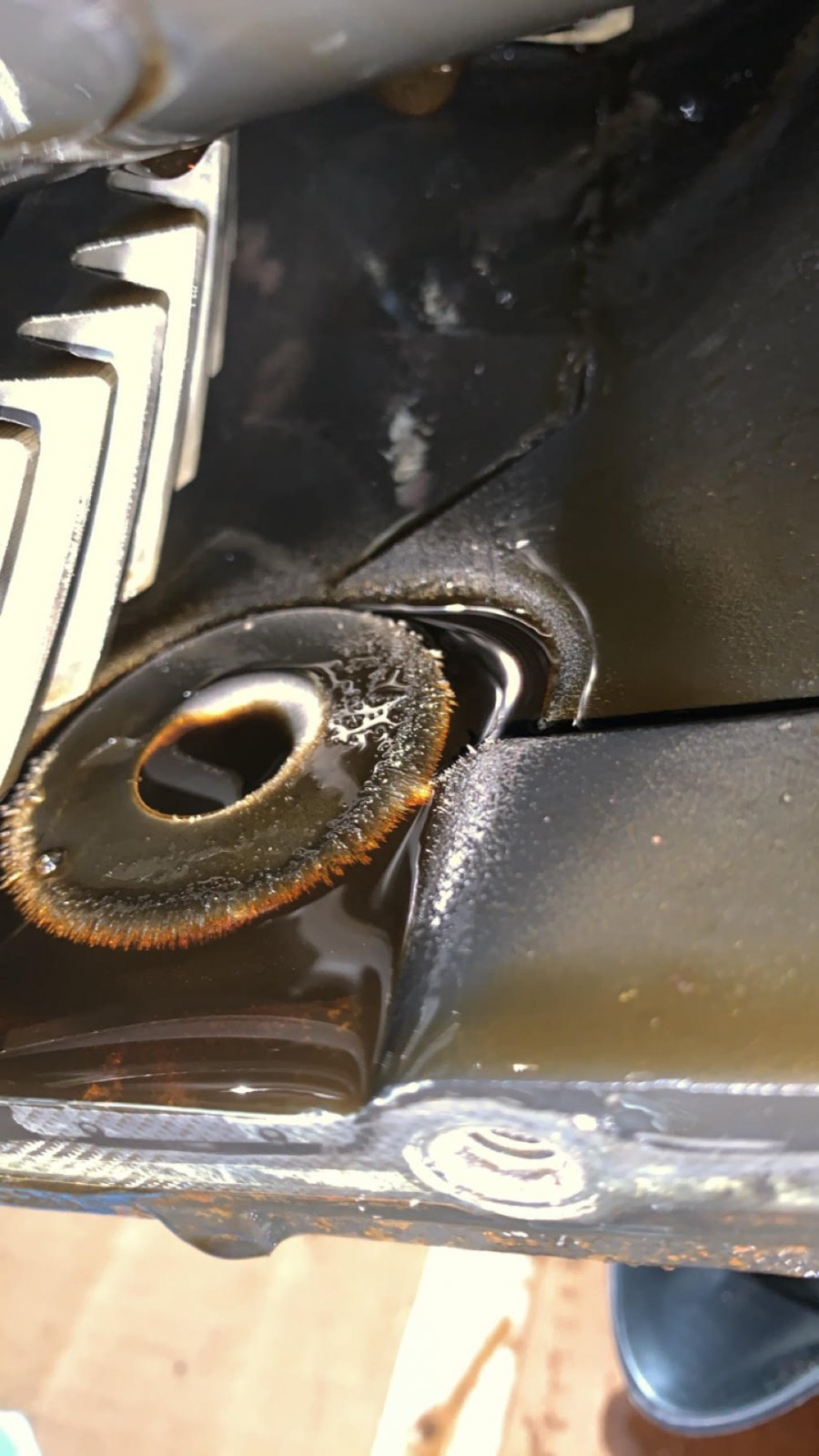

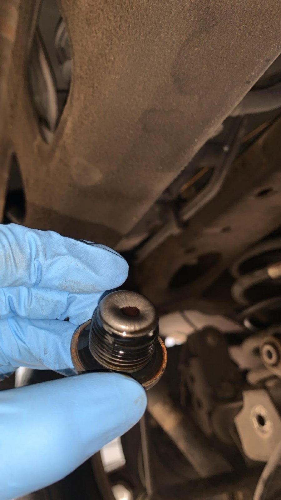

Good evening,
Changed the rear diff oil on my 2016 Yukon w/ 98k miles. I think it has never been changed due to the color.
Followed some YT videos, and finished in 1.5 hours- I've never done this before so I took my time and did everything carefully.
I used AC Delco 10-4016 75w-90 Gear Oil, the diff took ~2.5 qts.
Here are some pics.

I just did this on my 17 as well, mine called for 75-85 gear oil not 90. Not sure it would make much of a difference either way but might be something to look into just in case. I think its more important to follow the guidelines of either friction adder or no friction adder which if you used the AC Delco it should be correct without adder

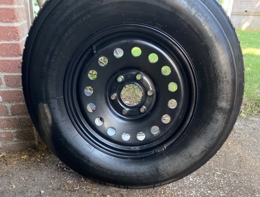

Went to check on the sensor harness near the exhaust for condition and all was good but one thing led to another and wound up refurbishing my spare and scraped and wire brushed the rust on the bottom. Hit it with a rattle can for now as I rarely drive in snow/salt
