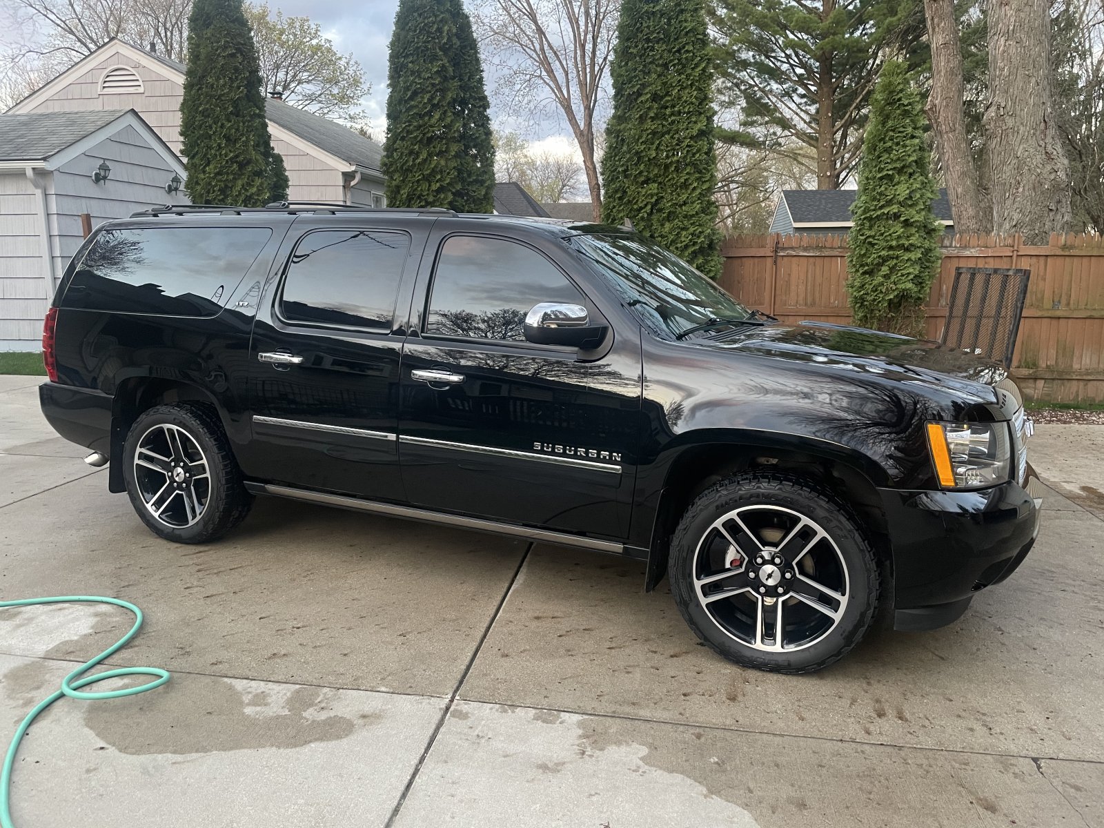

Our aquifer here is in limestone so we have hard water. The trick is to keep the truck wet until you are ready to hand dry it. I have to mist mine several times in the process.

Wash in the shade and dry quickly after you're done washing. As George said, if you need more time keep spraying it with the hose to keep the water from drying. If you don't wash in the shade you'll have a heck of a time regardless.
