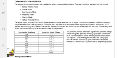

Not really a maintenance system its called rvc, regulated voltage control. It’s supposed to help with mpg. Basically alternator charges battery when it drops below a certain voltage, it can go up to as high as 15-15.5v down to 12v. It only charges battery when needed, like after first start which is what you are seeing and then drops off. If you unplug the sensor on the negative battery terminal your reading ‘should’ stay at a more consistent voltage, as long as your battery is good. Never hurts to test your charging system as doube said.

Looks like that's what it is. Found this:Screenshot_20180120-094051.png Screenshot_20180120-094259.png
