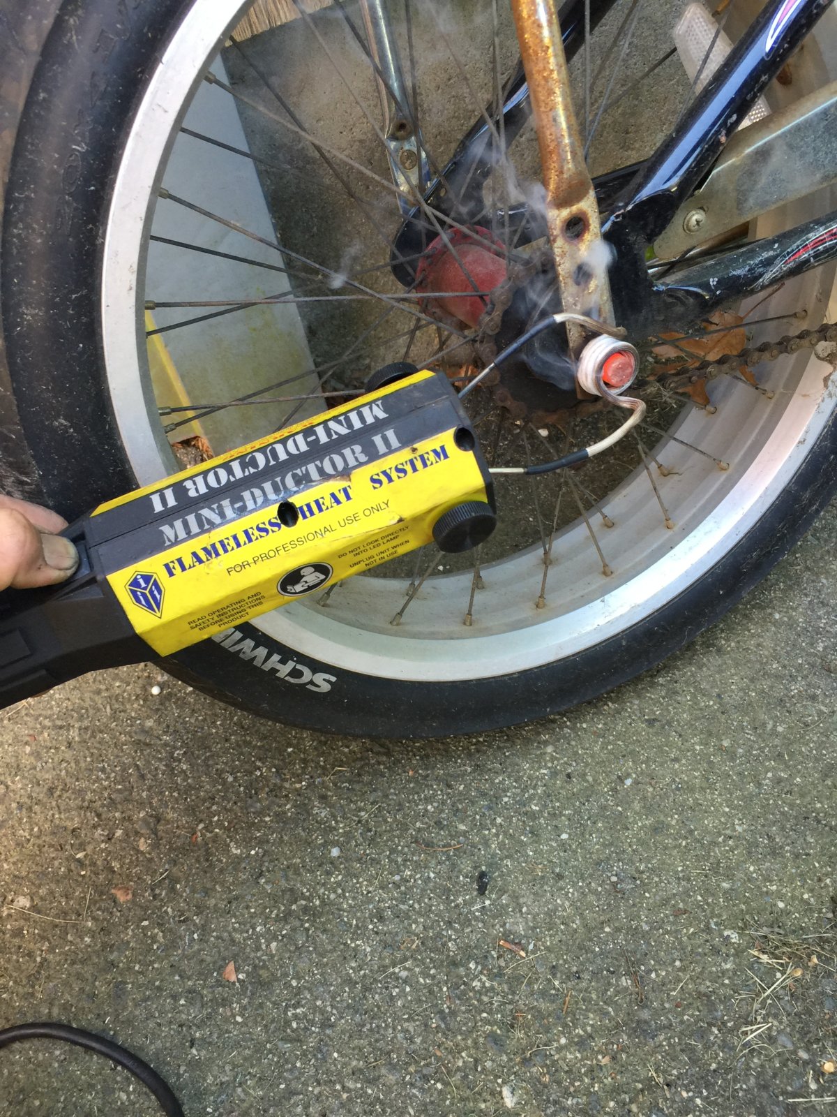

See if you can get your hands on of these. An inductor tool. Super heats anything inside the coil. When I have a stuck bolt and I can’t use a torch, I’ll use this to heat the bolt, let it cool and hit it again. This allows the bolt to heat entirely through. Call around. Some places may rent them
