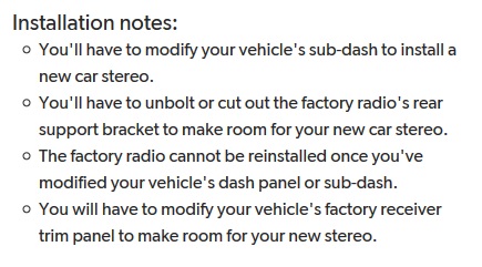

In my NBS I installed the Kenwood Excelon KMM-X503 (single din footprint, no NAV, no CD). I don't listen to CDs since all my music is either on a USB drive that plugs into the stereo, or I stream from my phone via Bluetooth. Since I have steering wheel controls I opted to get the PAC SWC adapter, and Crutchfield provided the Scosche GM dash kit for free. One thing that I didn't like about the dash kit was that it added another pocket, one too deep to use for much of anything. I'd just as soon have had a blank panel below the radio.
In order to install a double din or nav unit in an OBS some of the dash around the radio pocket will need to be modified. This is what Crutchfield shows for virtually every double din / NAV install:
You may also need to change out your speakers. I had replaced mine a couple of years before changing out the radio.
If you have a reputable shop that does good work, it might be worth it to buy it there, using their experience and expertise to get a job well done. Perhaps they could discuss in detail what modifications they'd need to make, and maybe show you some pics of a similar install.
