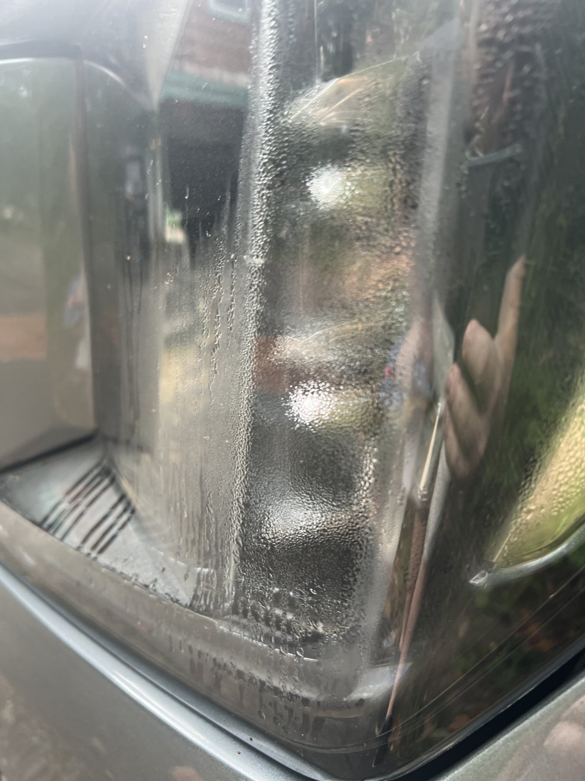

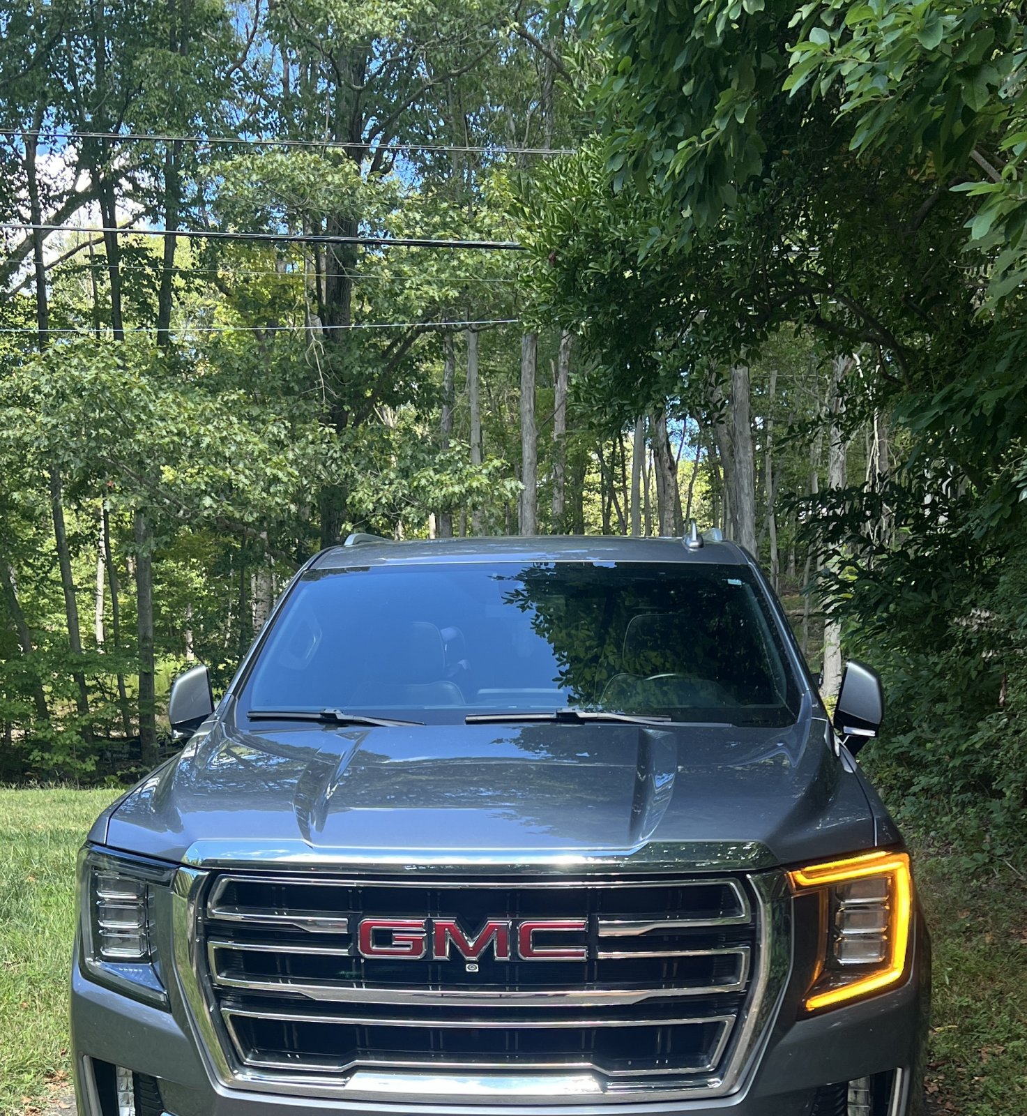

Hi all,
I encountered a weird issue tonight with my 21 Yukon SLT. Got a message on the dash to check front left turn signal, and when I got out of the truck it was illuminated solid orange. This remained illuminated even after shutting it off and locking it. I also noticed the headlight assembly has moisture on the inner part of the glass. Was going to bring it to a dealer, but figured I'd see if anyone here has encountered this before and knows a solution.

Wow! That's a lot of condensation. I would remove the light assembly, dry in out, and look for the point of entry for the water, as it may be easily fixable.
While you've got the assembly out, inspect all of the bulb sockets and look for water-related corrosion on the contacts. This may be the cause of the light's odd functioning.
