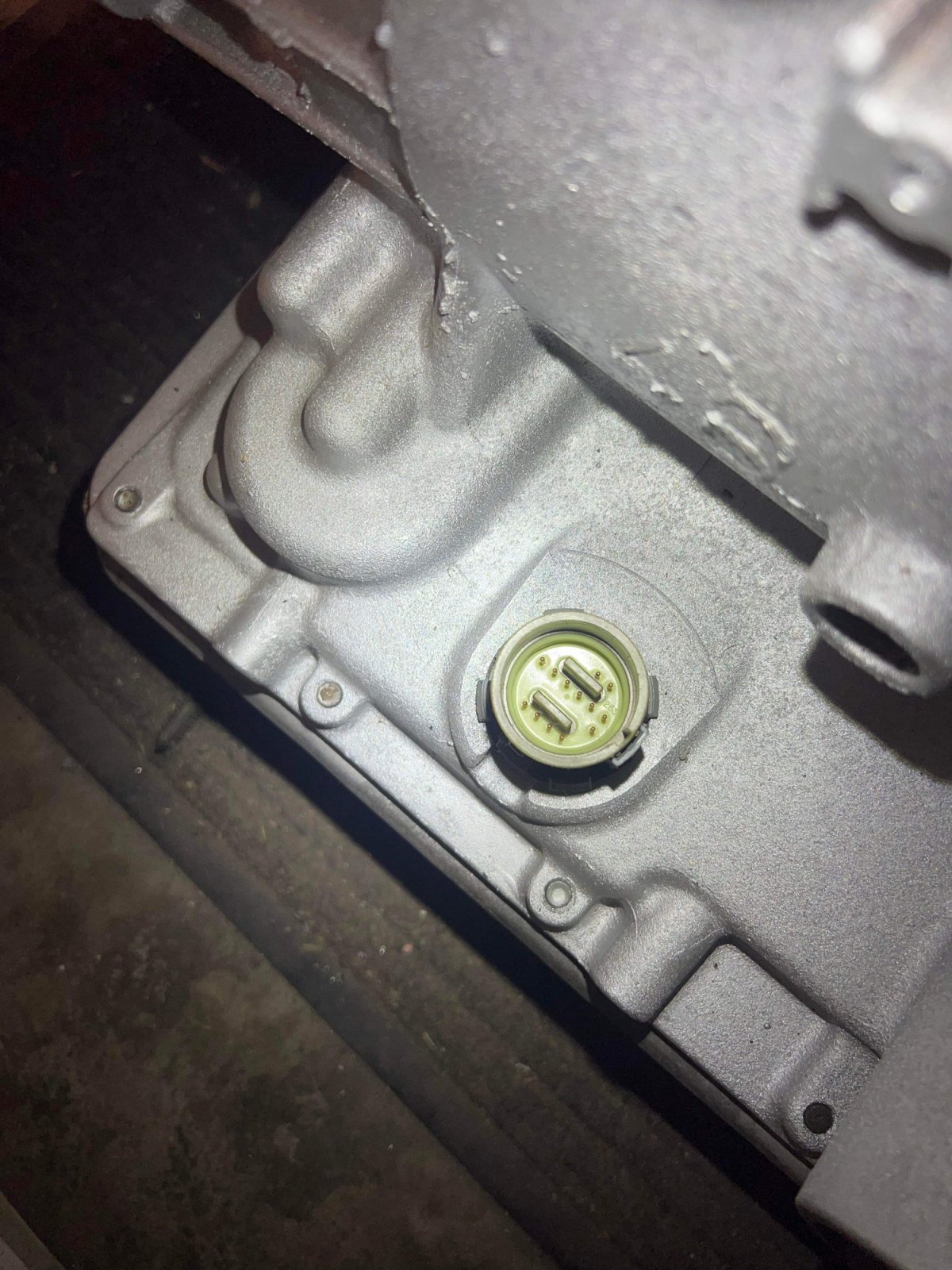

This sounds like either an internal transmission issue, an electrical connection issue or maybe the throttle position sensor is going bad. If it was the tune, it would be all the time.
Check to see if the electrical connector on the passenger side of the transmission is loose.
If that seems good, then you may need to have someone with a scanner look at how the throttle position sensor is reading. If the computer thinks that the throttle isn't open enough it will not shift right.

Check your servo travel, should be between .075 and .125...Sounds like the band could be slipping in 2nd and wearing out. Intermittent issues can just as easily be mechanical, esp if you dont have any transmission DTCs stored so dont assume they are only electrical or electronic.
Installing a 093 servo aka Vette servo and transgo basic shift kit (SK4L60E) would help if in fact the band is slipping.
Also scan it using something that can render live trans data as well as engine data. Could be the TPS like @Mudsport96 mentiond though the most common symptom of failing tps is super late, harsh shifts.
There are no servos underneath the pan, you're prob referring to shift solenoids A & B.
