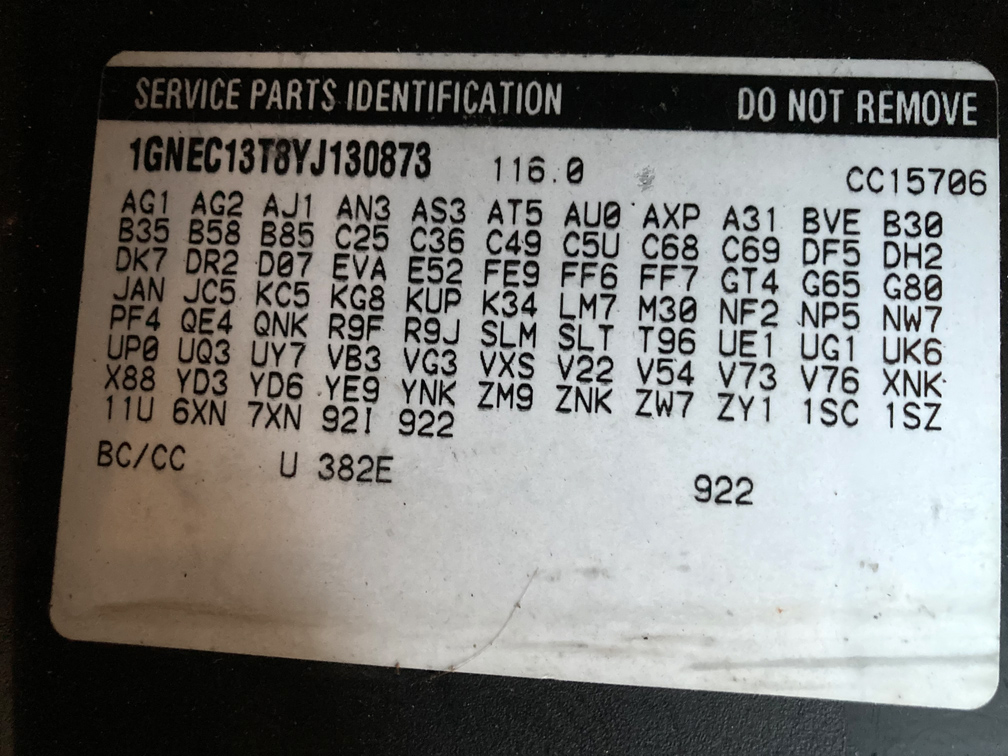

^^^ THIS. You want to avoid having the transmission constantly going in and out of 4th gear.
What are the "Gxx" RPO codes that are on the sticker in the glovebox? That would tell us what the diff ratio is.

Thank you all for replying!
Marky — Apologies. TBH, I didn't understand most of what you are saying. :/
Also, I'm not as concerned about gas mileage. I'm mostly concerned about burning out my transmission (again)!
Fless — Attached is the info from the glovebox. But, I can't make heads or tails out of it.
Doubelieve — I believe the thought from the transmission mechanic (Florida) is to keep it in "3rd", instead of "D", which I think he was saying was actually "Overdrive". I think he was saying that overdrive would wear out the transmission, by constantly shifting.
Bonus question: Is "3rd" the same thing as "D" with "Tow/Haul" engaged? (If so, I hate the way it lurches when it shifts - with or without a trailer.)
I appreciate any insight anyone can share!!

you have 3.73, there should be no reason to put it in 3rd.

Ok, good, you're more concerned with your 4L60E's longevity than with MpGs.
Your glovebox says your rear axle is 3.73 (GT4).
'D' allows all 4 gears. '3' disables 4th, allows 3rd, 2nd, and 1st, applies overrun clutches during decelerations in 3rd.

PCMperformance dot com charges $250 to tune a P01 or P50 PCM. (Yours is a P01.)
Mail in a (as in ANY) 12200411 pcm, it comes back with a plug&play, turnkey offyego tune. No credits involved.
