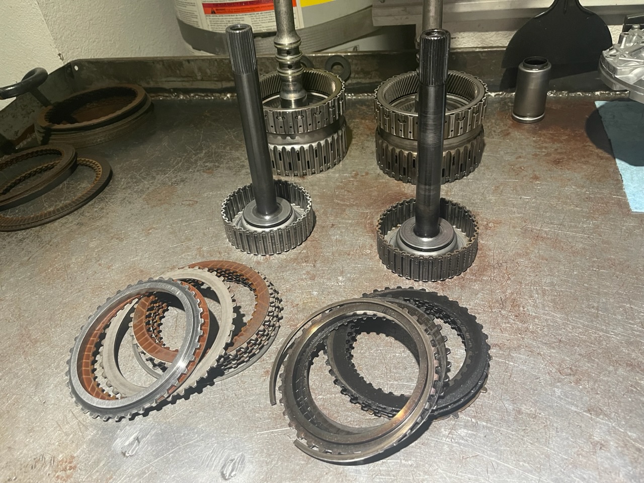

Below is an example of what overheating does to the 6Ls , specifically...The 4-5-6 Drum/clutch. The pack on the left shows normal wear where temps were largely well-managed while the other one suffered several overheating events before being yanked.
