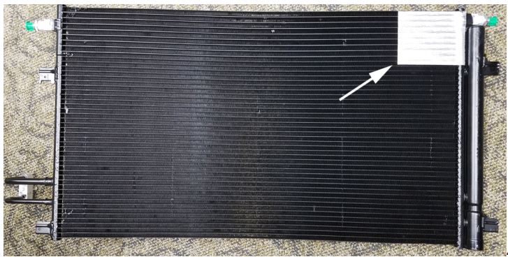

I have a 2019 Denali 6.2 L Max Tow that has an aux trans cooler in front of the radiator. See picture. The top few inches are the trans cooler and the bottom is the A/C condenser. I drive a lot in the mountains and tow a 6500lbs+ trailer. Even with the additional cooler I can tell you the drive out of Sacramento up to Donner Pass (in the summer) has been the toughest on my transmission temperatures of any trip I have taken in the mountains. Even worse than the climb out of Denver west on I 70. Once my warranty expires I'm looking for alternatives.

I have a 2019 Denali 6.2 L Max Tow that has an aux trans cooler in front of the radiator. See picture. The top few inches are the trans cooler and the bottom is the A/C condenser. I drive a lot in the mountains and tow a 6500lbs+ trailer. Even with the additional cooler I can tell you the drive out of Sacramento up to Donner Pass (in the summer) has been the toughest on my transmission temperatures of any trip I have taken in the mountains. Even worse than the climb out of Denver west on I 79. Once my warranty expires I'm looking for alternatives.
Just so we can compare apples to apples, what do you mean by 'tough'? What was your fluid temp by the time you got to the top of that pass? How heavy is/was the trailer you were towing?
At one point got up to about 240-250 degrees. Short of the red line. Towing a trailer that at scale is 6700lbs loaded max. Maybe a little less since this was the return trip and we had left some items behind with relatives. Very warm day, steep climb that slowed us down to 45-50 mph on the uphill so not a lot of airflow. Lots of ups and downs so it would quickly cool off only to go back up again on the next hill.
Yup. Got it. It’s uncomfortable to see but it’s normal.
On the earlier Denali’s, the problem we’ve run into with aftermarket coolers is that adding a larger than stock cooler in front of the radiator has the unintended consequence of reducing engine cooling capacity and raising engine coolant temps… so much so that guys have gotten engine temperature warnings and had to stop.
So, my opinion is that the best solution beyond factory is one that cools the transmission fluid more than the factory setup can, but not as much as a much big cooler like the Trucool 40k will. I’m my case, I mounted a Derale 13960 fan-forced cooler below the front bumper and it’s the perfect setup. Again, in my opinion
