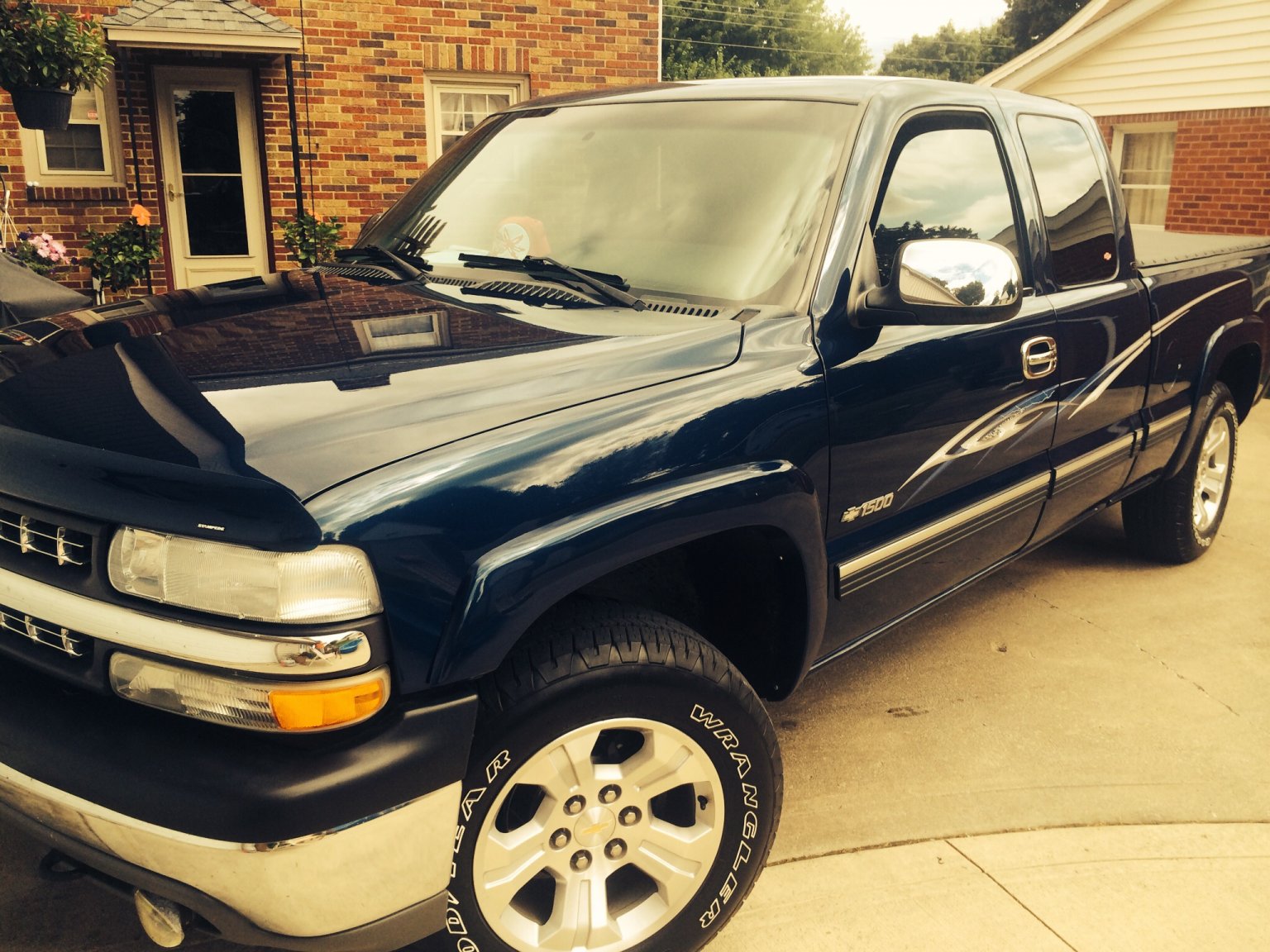

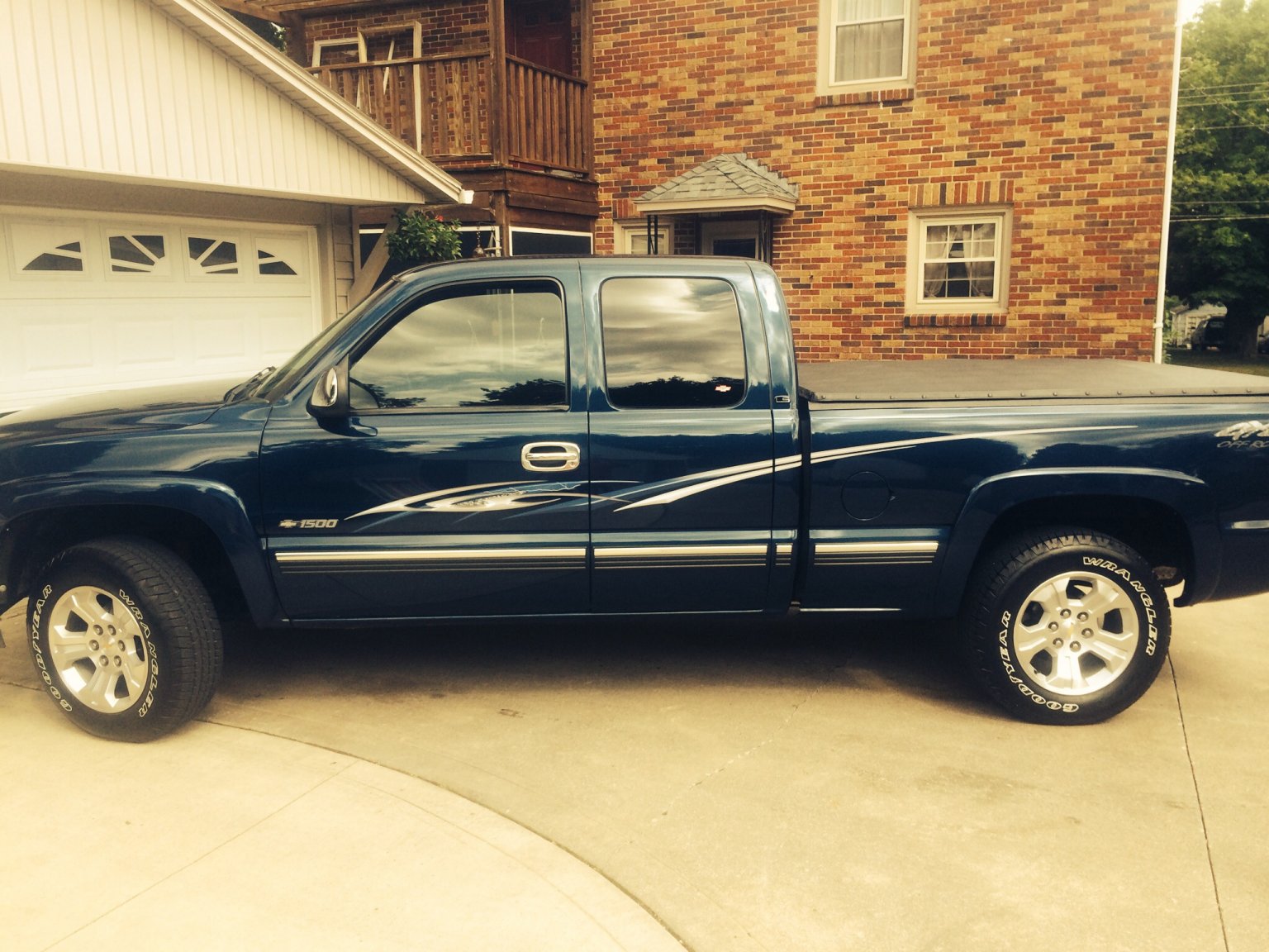

Almost 100%. I crawled under there quickly and both seals were dry but all around the bottom half of th case where the bolts are was very wet. I'm gonna get under it again to double check. Here's 2 pics of my old buggy

Thx. Wheels are off a 2015 Silverado. The leak looks more like it's coming from the rear output shaft. I can see the spot where the holes can happen looks ok
