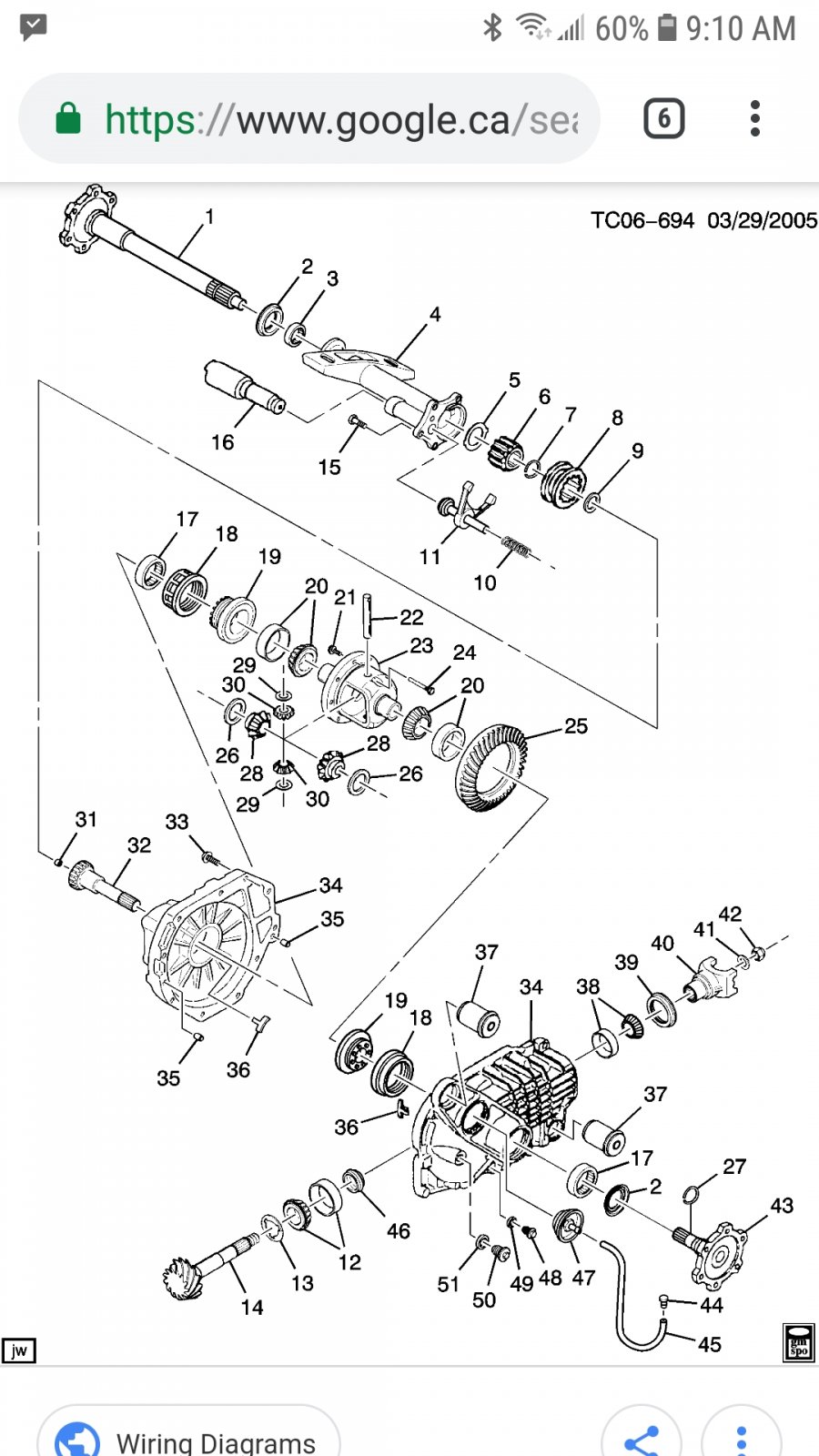

Never had much luck with anything from dorman, especially electrical items.
But as said above when the diff is called to work its the whole diff and not each side that engages.
# 6,8,and 32 complete the front diff engagement.

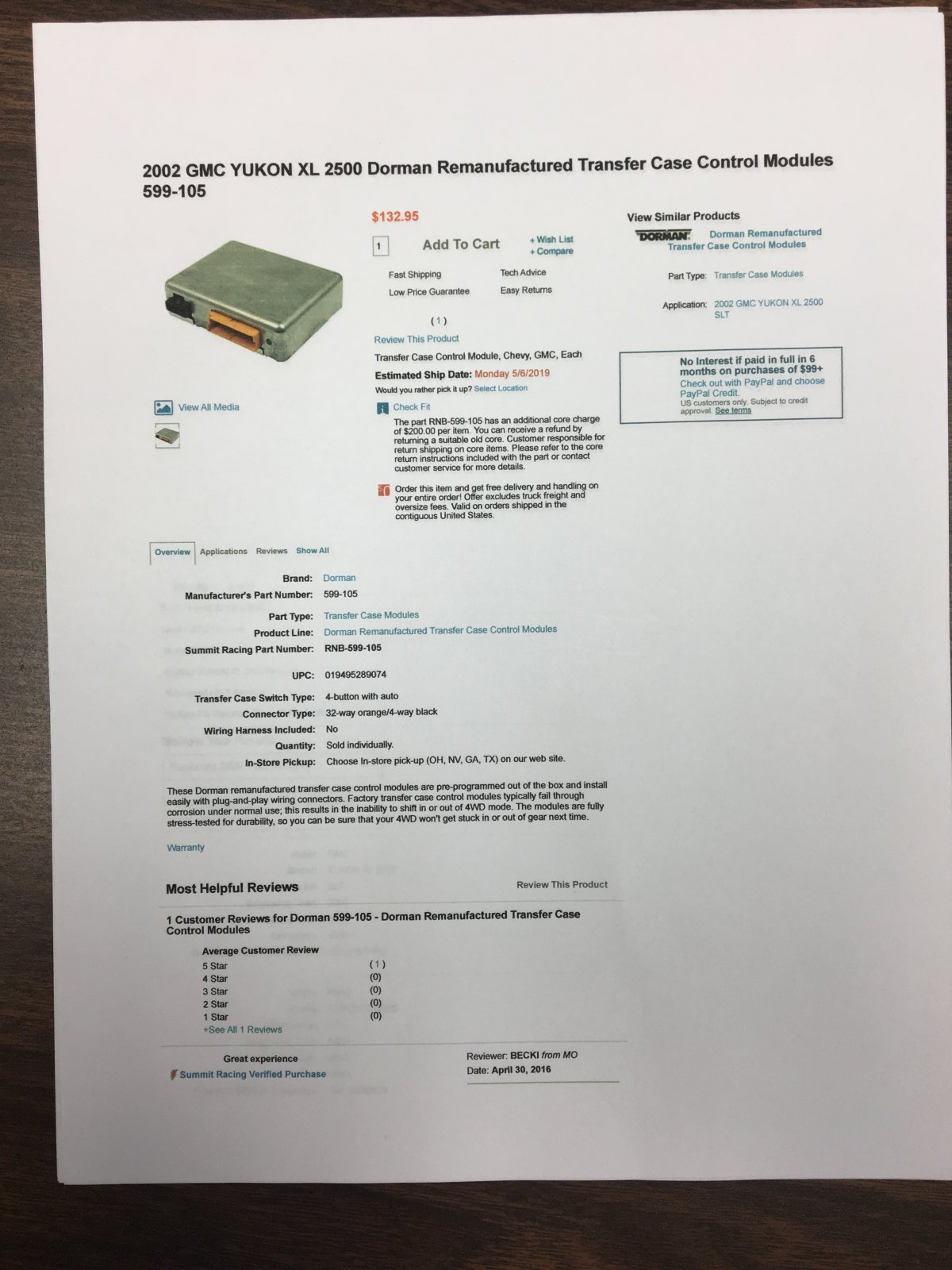

So, first of all, my apologies for taking so long to reply back on my thread. My mechanic says he thinks the Dorman pre-programmed TCCM has fixed my issues. He still has my suburban working on other issues, but says he's been driving it some (as I asked him to do) and there seems to be no more grinding noise coming from the front of the suburban. I'm keeping my fingers crossed that this has my problem fixed. Thanks to everyone for all their help.
02 Yukon Guy
Dec 21, 2018
24
The above post was the sheet describing the TCCM that was bought for my 2002 GMC Yukon XL 2500. So far, (fingers crossed) it seems to have fixed my problem. I have not had any troubles since my mechanic performed the install. Can't complain about the price. Much better than the cost of taking it back to the dealer for a re-program (as long as it stays fixed!). Just wanted to post the info that some of you had asked for. Hope this helps someone.
