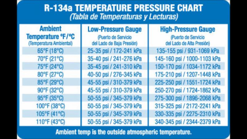

Some in the system allows pump to run till nothing there, so 5-20 seconds. Add a couple cans try to match chart lowest pressures for temp.(less likely to overfill.) The green is dye, so push that around awhile and look for leak. Wash off low side fitting well. known for slow leaks there. check condenser, all fittings, and gaskets to start with. Thats the cheap way $5 per can. When compressor runs you can try inside controls.
