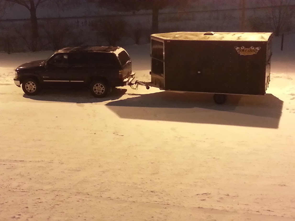

Pulled this thing every winter weekend for many years. In many cases when no one else wanted to be out.
No problems, it just loved the gas because of the wind resistance.
(I'm have a new trailer being built this week that will be 6 feet longer)
That 2002 Tahoe had the 3.73 gears that came with the tow package.
My 2014 Tahoe also has the tow package, but has 3.42 gears.
