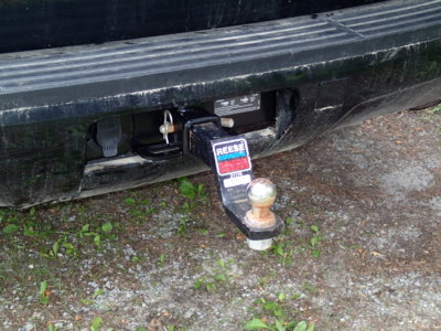

Update for aftermarket Curt hitch installation result:
Curt hitch for Tahoe PPV, part # 13161, same as the above video described, the installation time is short or long depending on how the original Tahoe hitch bolt removal.
My situation is that the one of 6 welding lock nuts was dislodged, so the nut became free spin. The nut/bolt position is on driver-side, close to rear bumper. There is no way to hold the nut with any kind tool without removing rear bumper. So finally, I cut off the bolt hex-head, and left the lock nut and the rest of bolt inside rail. And also, left one bolt is not being installed.
The hitch is low, around 13-5/8 from ground. So, to tow some thing, there should be a raised hitch ball and a raised ball receiver to be needed. I checked U-Haul, their smallest trailer's coupler height is 25-in.
So, I will order 2-in raised hitch ball and a 8-in raised hitch receiver from Curt.

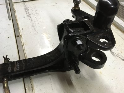

I am about to order following raised Curt parts:
CURT Trailer Ball #40034; Shank Rise 2 IN
CURT Class 3 Ball Mount #45110; Rise 8 IN
The towed items are an U-Haul 5 X 8 cargo trailer, with Empty weight 900 lbs, plus a Vortec 8.1L engine as cargo, weight around 700 Lbs. So the total weight is below 2000 lbs.
The newly installed hitch should hold that weight even missing one bolt.
The aftermarket hitch is bolt to chassis from bottom, please see the attached pix.

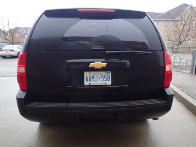

I've just installed an OEM rebar/hitch on my '14. It was a bit of a pain,
but if on a hoist it is relatively easy and took less than an hour.
The wiring is there and the socket part is readily available.
( Lol - I found a scrap hitch/bar a week later )
The heaviest I'll be towing is a 1,600 lb Palomino pop-up trailer.
Pics of before and after......

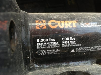

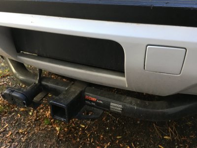

I just bought a 2012 Tahoe PPV to tow our recently purchased 21' travel trailer. It had no hitch when purchased so I had the dealer take care of that and the 7 wire plug wiring. I installed a Tekonsha electric brake controller myself and did the setup for the Reese 10,000 lb. weight distributing hitch, which came with the trailer.
I noticed there was no "tow mode" switch, and from what I have read GM says the PPV's are not intended for towing... yet the trailer wiring was very conveniently there, nicely tucked up under the dash, and along the rear frame rail. Even with the suspension sitting lower, and the 6000 lb. Curt hitch mounted under the bumper, I was able to setup the Reese ball mount so that our trailer sits level. Loaded, our trailer GVW is about 4000 lb., about 500 lb. tongue weight, and there is plenty of clearance below the hitch. The torsion bars don't work very hard distributing the weight, and with the PPV's stability and additional cooling we haven't had any issues so far. Without the "tow mode", it does shift from 6th to 5th frequently, but I find with a little attention to road grade, I can avoid the shifting with increased accelerator pressure approaching hills.
From what I read here there are several of you hauling various trailers without any issues... hopefully we can keep sharing our experiences and learn from each other...
