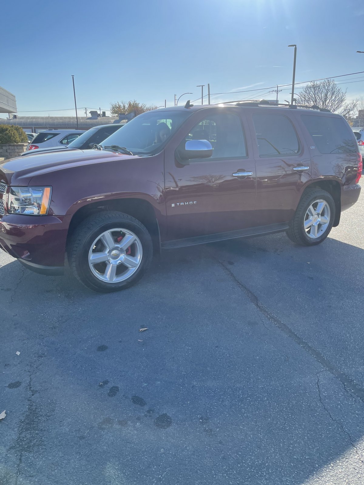

This is my only picture of it so far. It’s got 162,000 miles. I was thinking about putting slam specialty air bags on just the rear but that is gonna be pretty expensive and it is 4wd. Is suncore industry worth looking into if I go back to the stock air ride? And does the stock air ride last long in the salt belt? I’m from Indiana thanks for the help

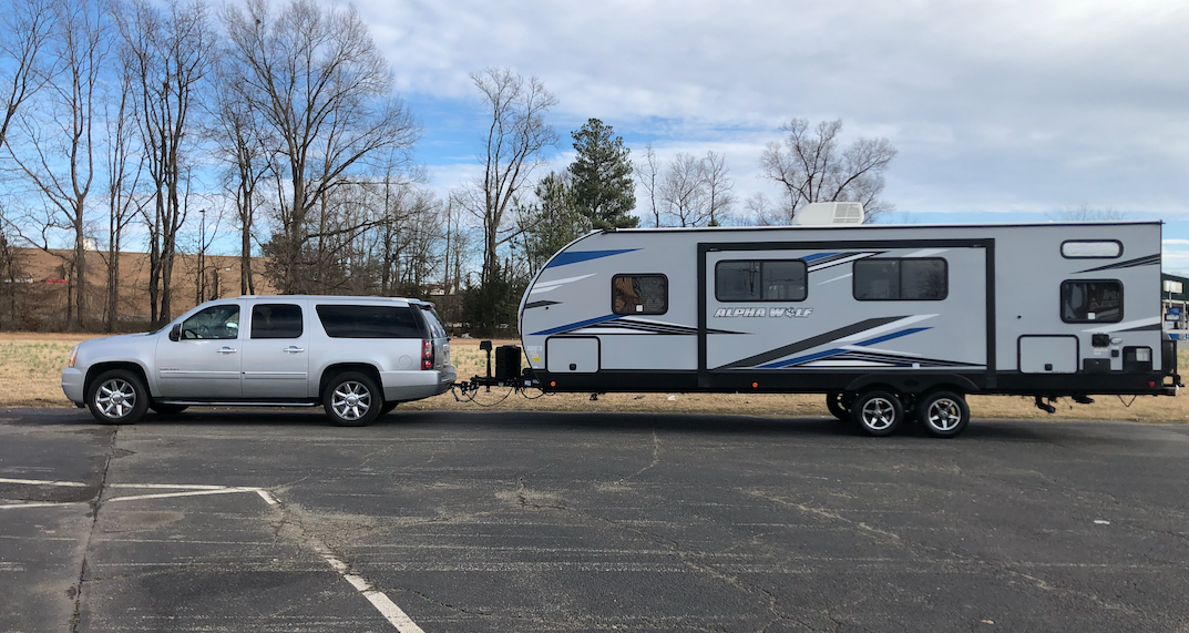

I tow a 7000 lb camper with mine and agree with Bill that repairing the factory system is the way to go. It's actually a super easy system to work on. You can buy new OEM rear air shocks from Rock Auto for $250 each, and a new compressor for $200. The Dorman compressor is excellent, and when coupled with a properly set up weight distributing hitch, will completely eliminate any sag.
