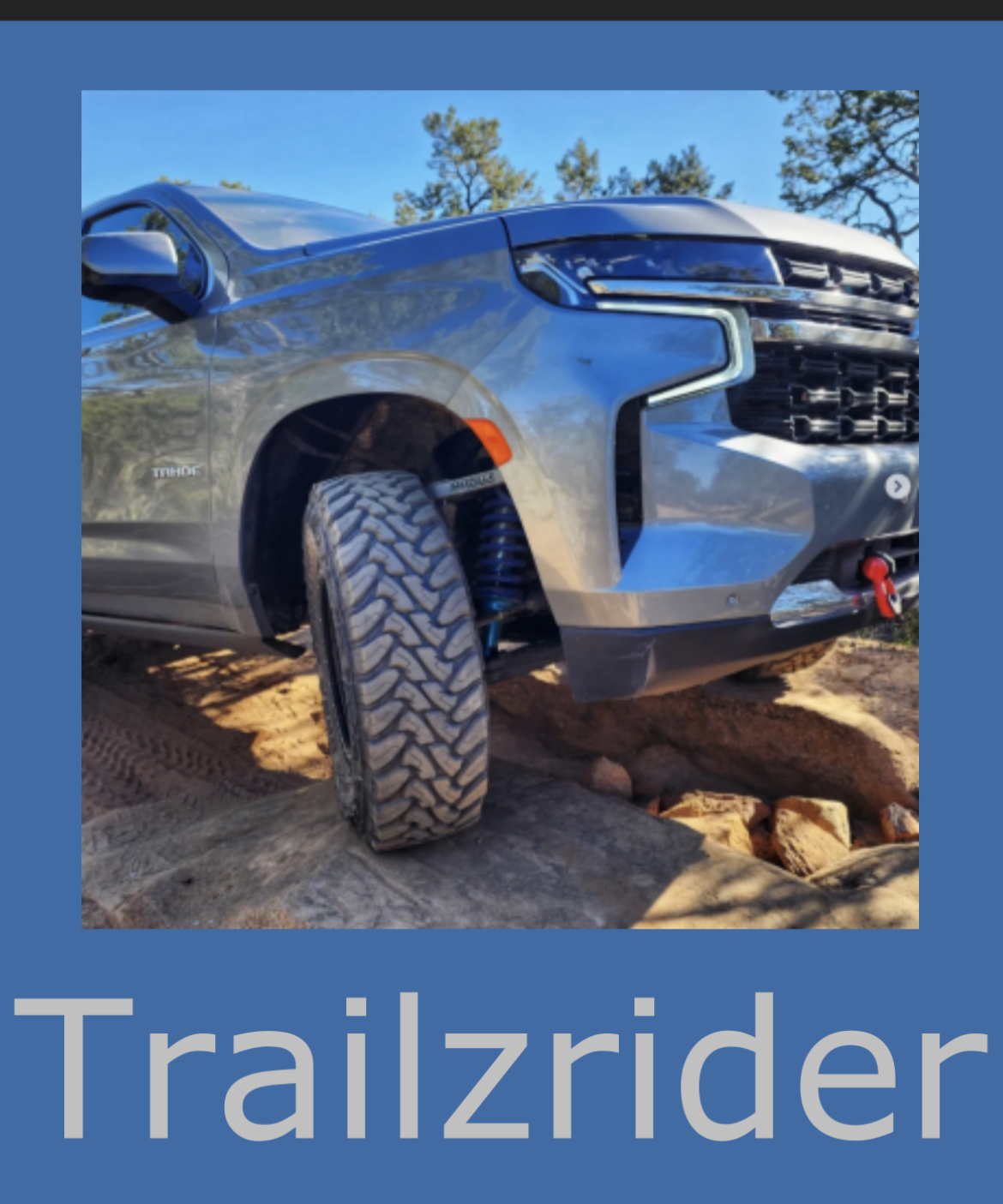

It looks like you can add the rough country shackle brackets to the driver side front end and it will work. A member of this board, trailzrider, has a profile picture of this. Note, trailzrider does not have adaptive cruise so he has recovery points added to driver and passenger sides of his vehicle.

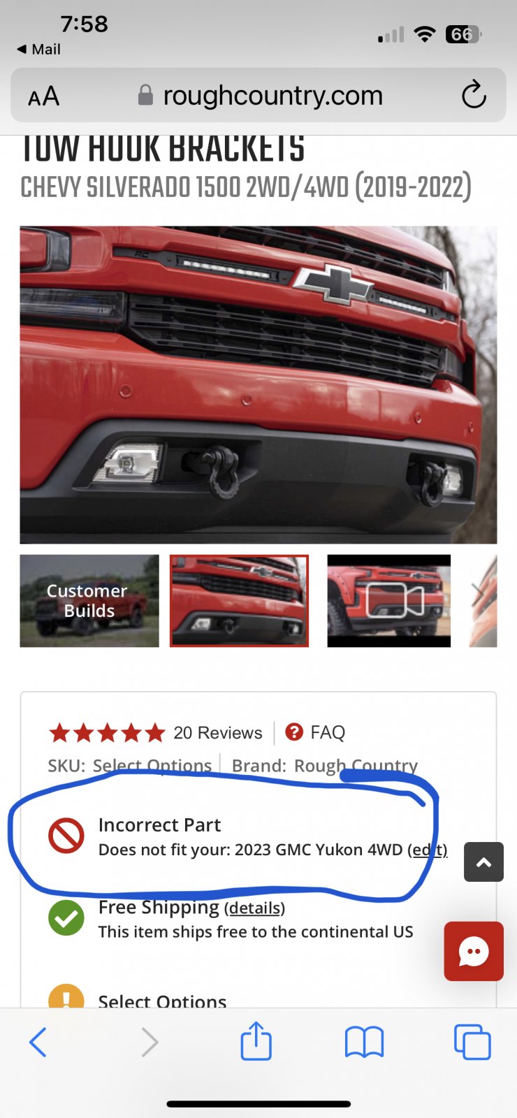

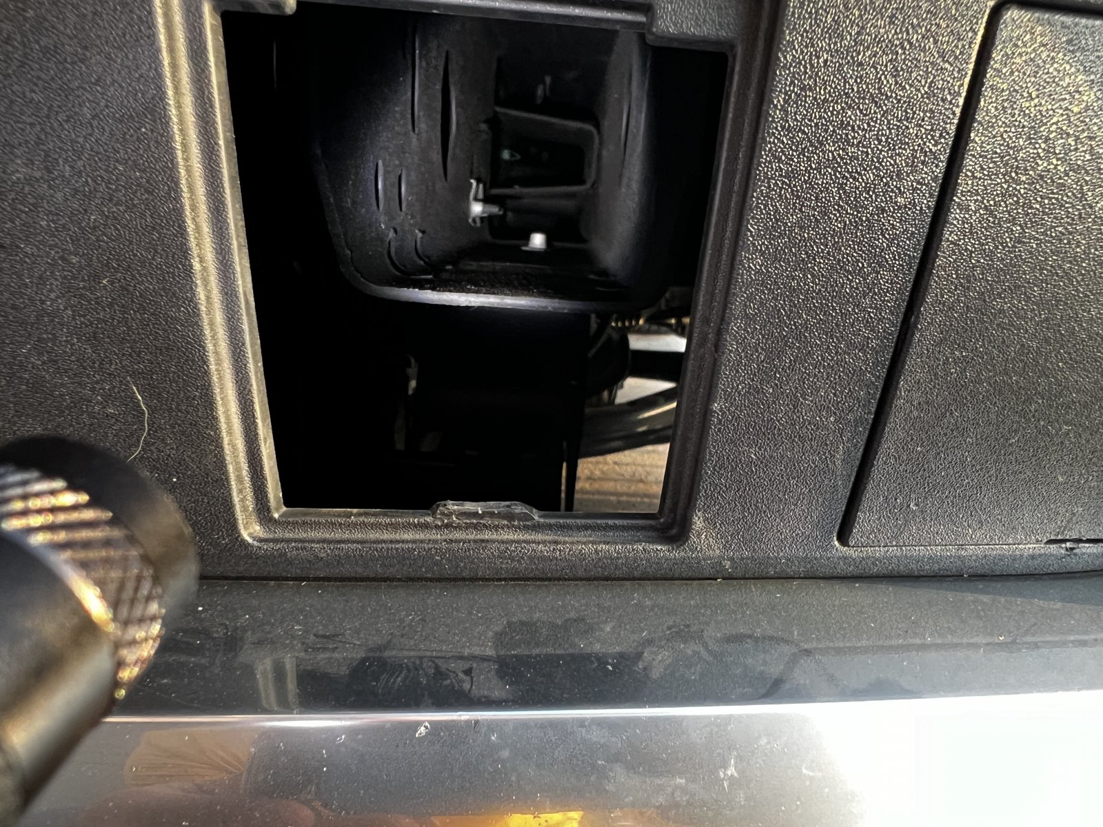

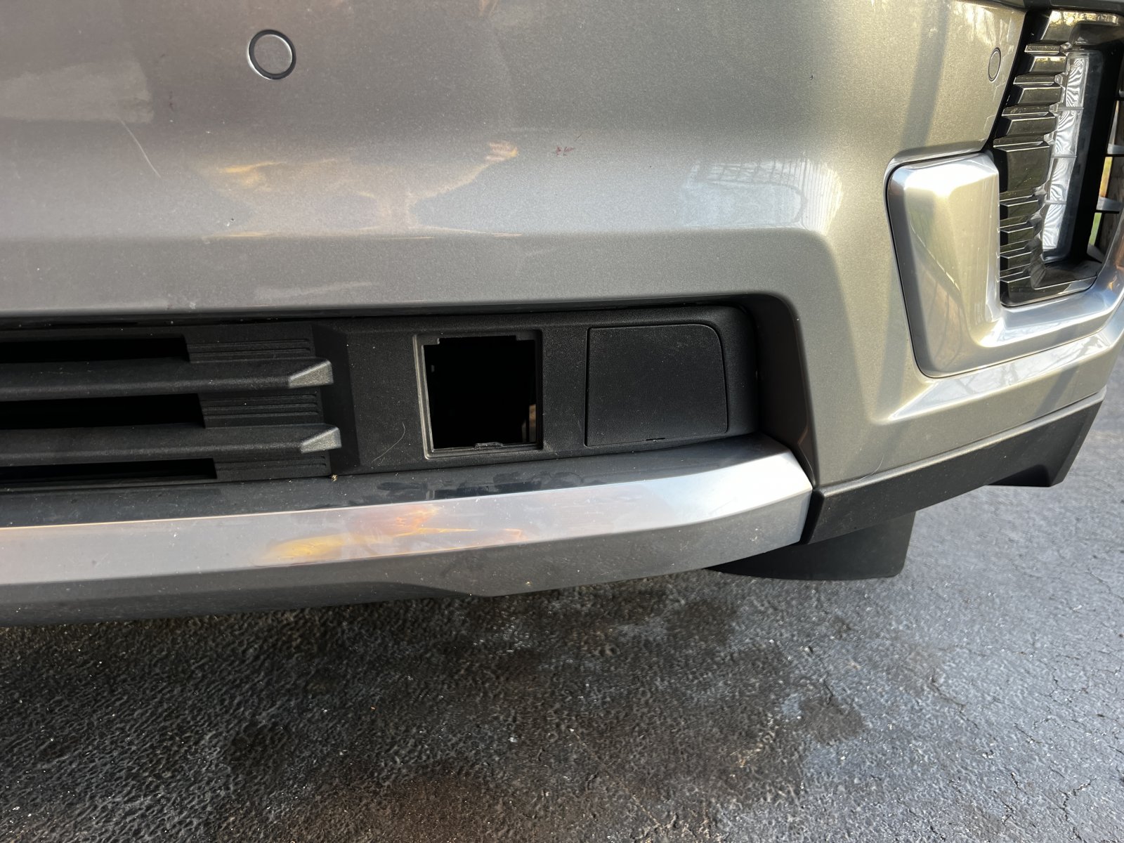

@d_hawk & @Trailzrider - The Rough Country fit guide says that this will not fit a 2023 Yukon Denali. Do I buy it anyway? I do have the port hole on the driver’s side next to the engine heater port hole (Duramax). Appears to be open to framework behind. Do you know if this will work? I will only do the one side due to adaptive cruise.
Btw, we got stuck in deep snow last month and really could have used this on the front! Thanks in advance.

Rough Country said I had 30 days to return them. Let me slide under this thing this weekend and peek around and see what it looks like. I have to undo the lower cover stuff to see up in there; they do a nice job sealing up the undercarriage (wish it was all skidplates, ha!)

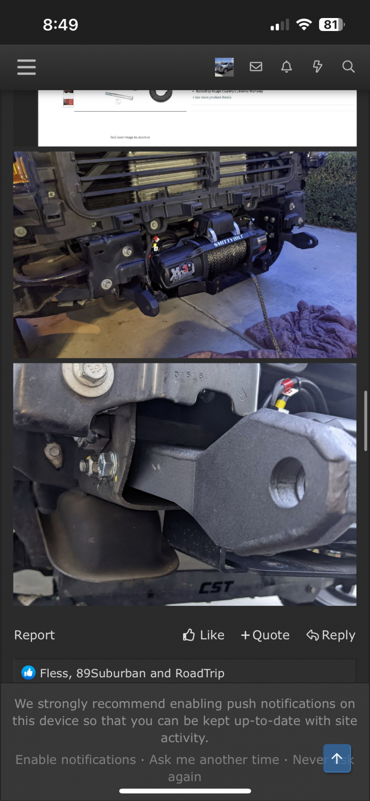

I found this pic in another thread. This is what my frame looks like behind that opening (the lower pic). I’ll know more when I open up the bottom and take a look, but this looks somewhat promising.

I do not have the adaptive module. All I had to do was cut the opening on the passenger side. I would like to sort out a winch mount. So far the ones I have found state they do not work on the diesel.
