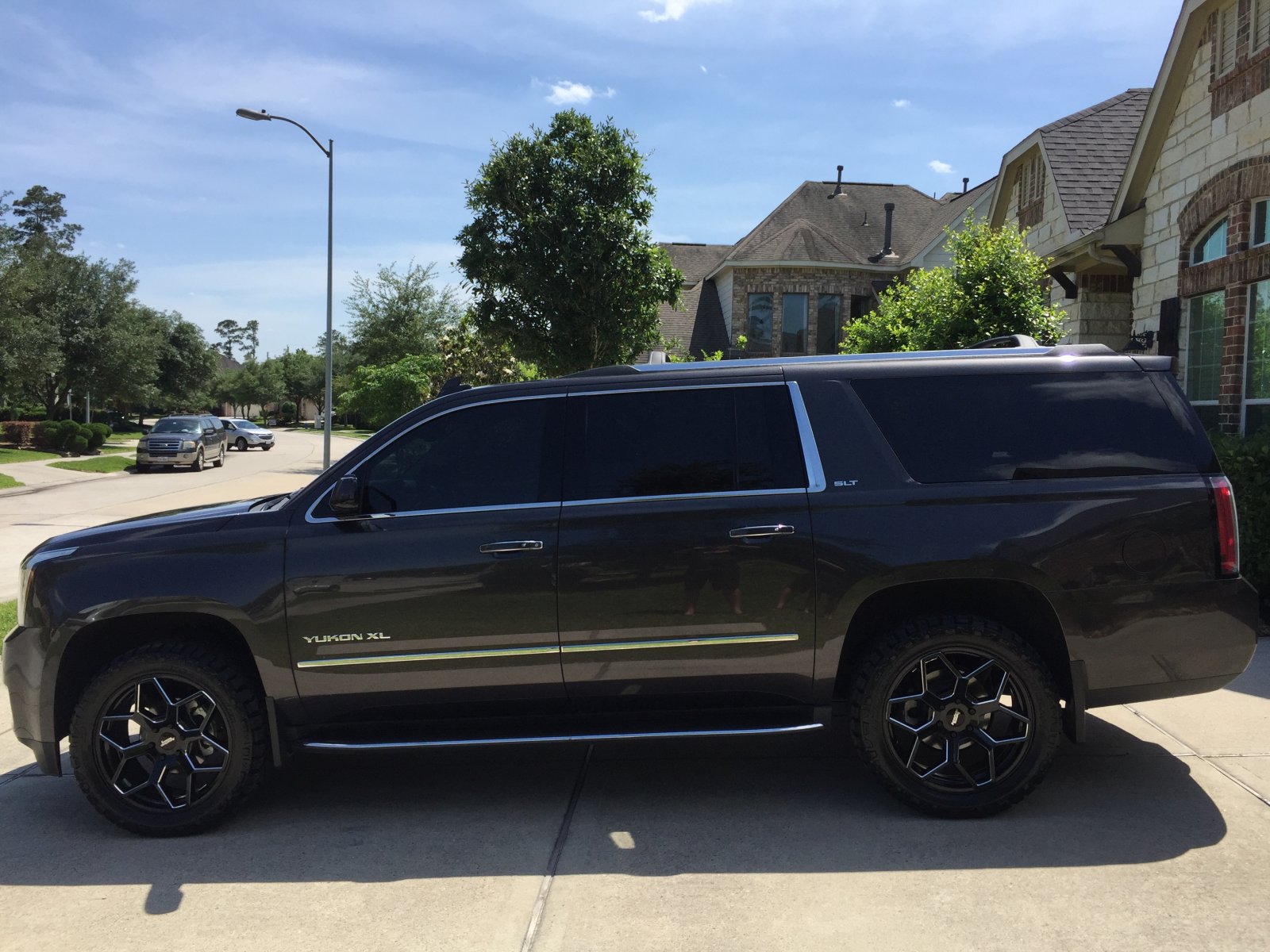

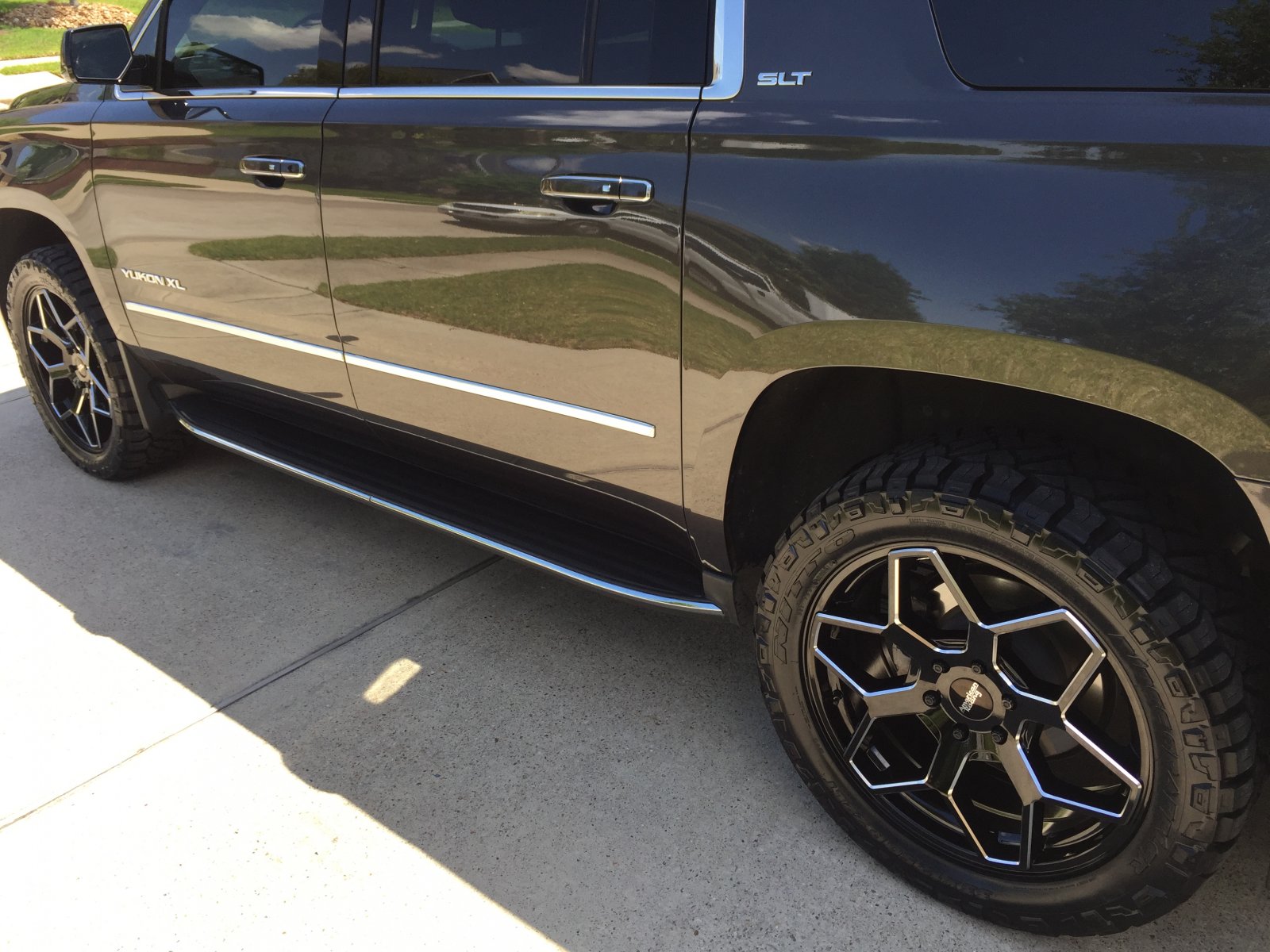

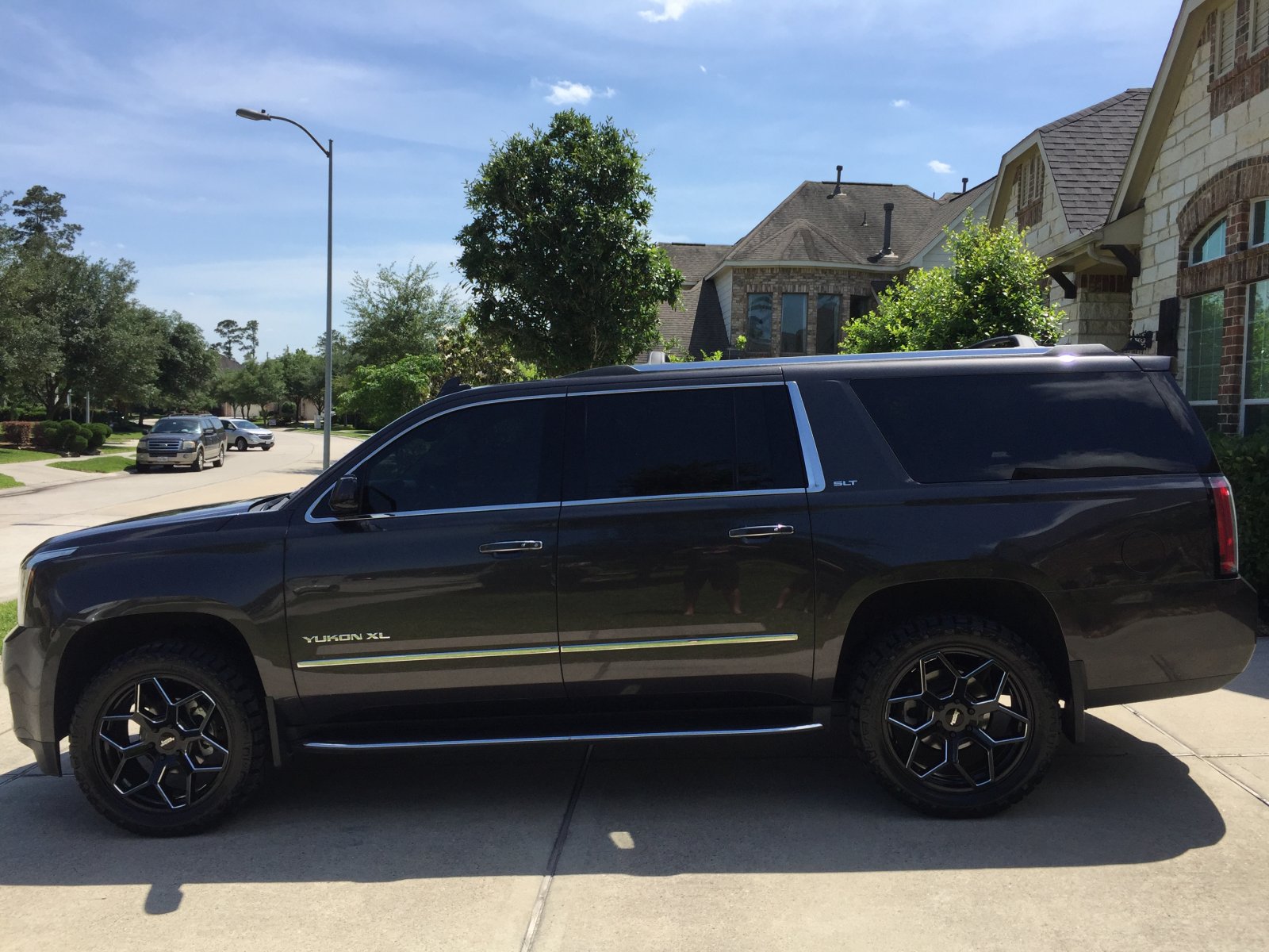

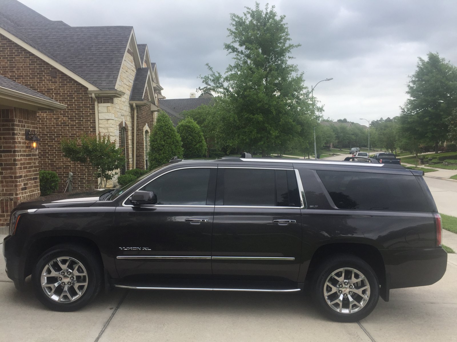

With inspiration from JennaBear and others (Thank You!), I finally got around to upgrading my GMC OEM rims about a 2 years ago from the factory (first pic), to some American Racing gloss black milled 22x9 +30 offset AR916 rims. Also went with some 33x12.5R22 Nitto Ridge Grapplers with a Rough Country 2 inch lift on the front (essentially the back remains technically 1/2 inch higher).
Loved how they turned out, and so far no rubbing (initially tried some Dropstars 654bm’s with a -25 offset, don’t do it, it is too wide, and I would be afraid going any wider than a +15 offset with this tire) and the ride is great and just as quiet as before. New specs are below...
-2016 Yukon XL SLT (Iridium Metallic)
-22x9 (+30 Offset) AR916 Gloss Black Milled Rims
-33x12.5R22 Nitto Ridge Grapplers
-Upgraded Factory Chrome Grill
-Upgraded to Denali Handles
-Upgraded to Denali Chrome Bumper
-Upgraded Tyger Chrome Roof Rack Molding Trim
-Upgraded Putco Chrome Back Door Molding Accents

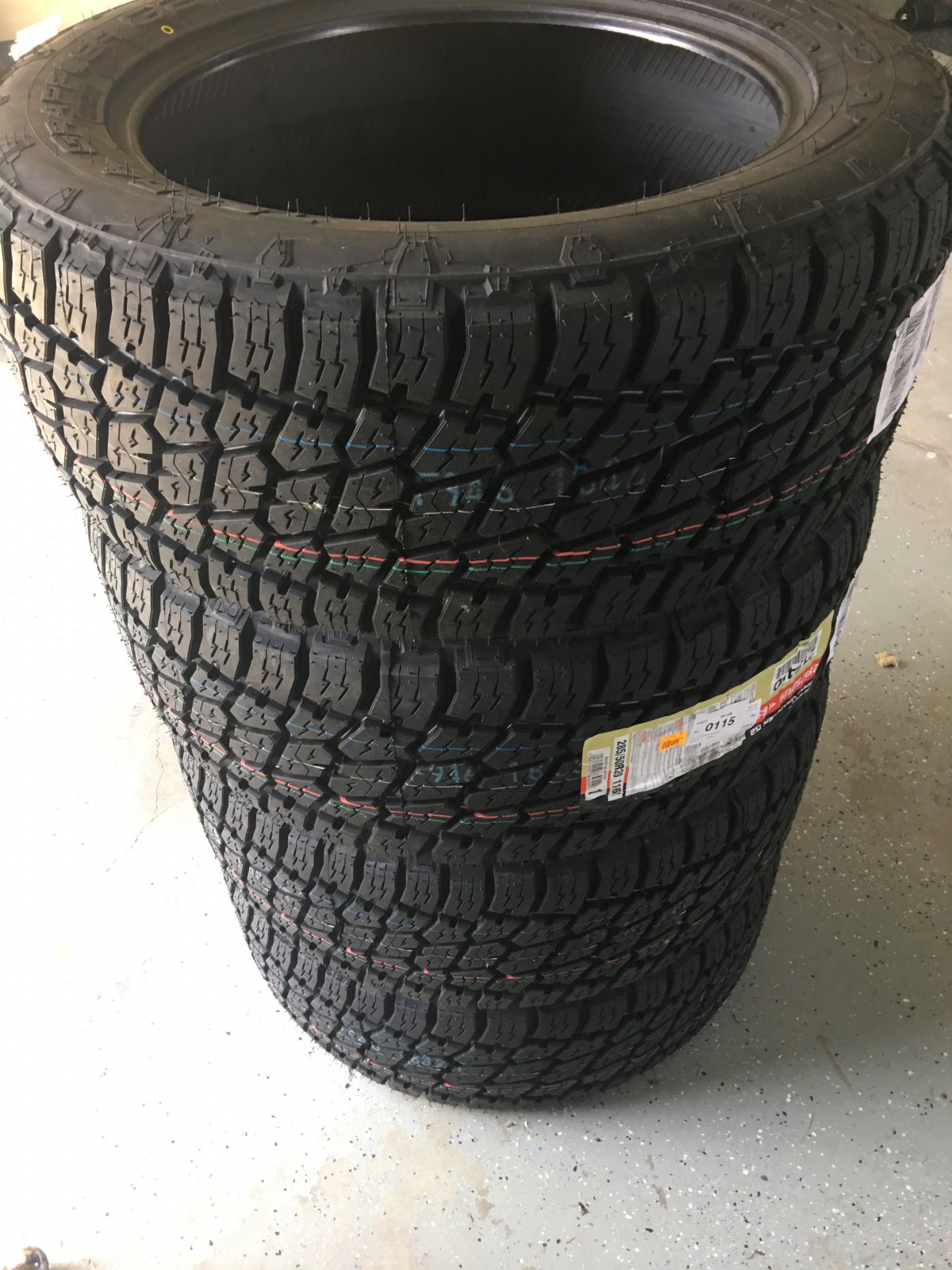

That looks great!! I ended up going with the terra grapplers I went with 285’s just to make it look a little better. I haven’t installed them yet I’m hoping that I’ll be as satisfied as you were with the ridge grapplers.
Awesome! Let us know what it looks like once you got them on. Congrats and look forward to seeing the ride.
