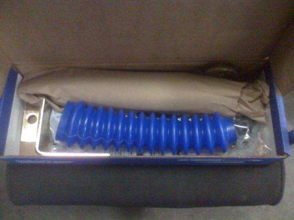

Here is what i got (all stock):
'99 4x4 LT Tahoe w/Bilsteins
Here is what ordered:
Rancho Steering Stabilizer
Polyurethane Bushings for Front/Rear Swaybars and End Links
I checked out the aftermarket sway bars, but didn't think it was worth the money so i went with polyurethane instead...was I wrong?
I'm open to all recommendations and ideas. My goal is to tighten up the truck b/c in its stock config, it's too sloppy for me.
Thanks in advance for any advice!!

If your looking to "tighten up" the steering i would go in there and replace parts, depending on how many miles you have the two big ones would be idler and pitman arms and possibly your tierods. It will make a world of difference, the steering stabilizer will help some, but it wont really tighten anything up so to speak. Worn out idler arms on our trucks are notorious for creating a lot of slop in steering so i would check the condition of yours.

Thank you for the advice.
Rig has 79k and driven like a baby, so I don't think it's the mechanics b/c it still drives like it's new...but I'll def check those items out, b/c its certainly possible for some premature wear.
Here is the Rancho i ordered:
http://www.autoanything.com/suspension-systems/61A2660A0A0.aspx
You might be able to find it cheaper at other places...i went with these guys b/c i got 15% off, free shipping, and a bunch of other parts. You don't need a lifted truck in order to use the stabilizer, but all lifted strucks should have them.
