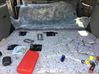

It idles consistent I only notice lag when i start accelerating and sometimes i have to hit the gas a bit more to get power almost as if i am going uphill. Tonight I am going to clean the MAf filter as well as the throttle body. I also have a Autel MaxiDiag MD805 so ill use that to check out the o2 sensors and fuel pressure and see what reading i am getting. Once again I really appreciate everyone help I am learning as i go so you guys are super huge help. Really love this car and doing everything i can to keep it in good shape. I attached a photo of the car a 2001 tahoe with barn doors and third row seatings

I did not know they did 3rd row with barn doors. My 2002 has barn doors with no 3rd row. I did learn something new today. I am diggin' the orange color and the black wheels. I am jealous of that look. Trade you. Mine is dark green.

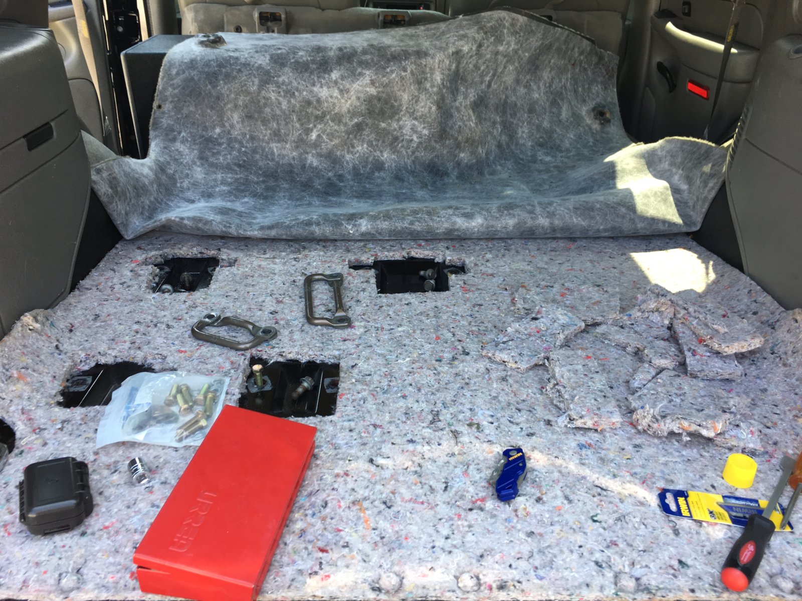

The car does not come with third row seats but it has all the holes for the brackets so all you have to do is lift the carpet up remove the plastic covering the holes and just buy brackets of ebay from a junk tahoe. Super easy to do and even found matching third row seats for the car.
