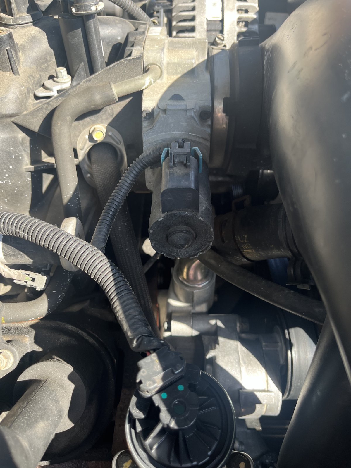

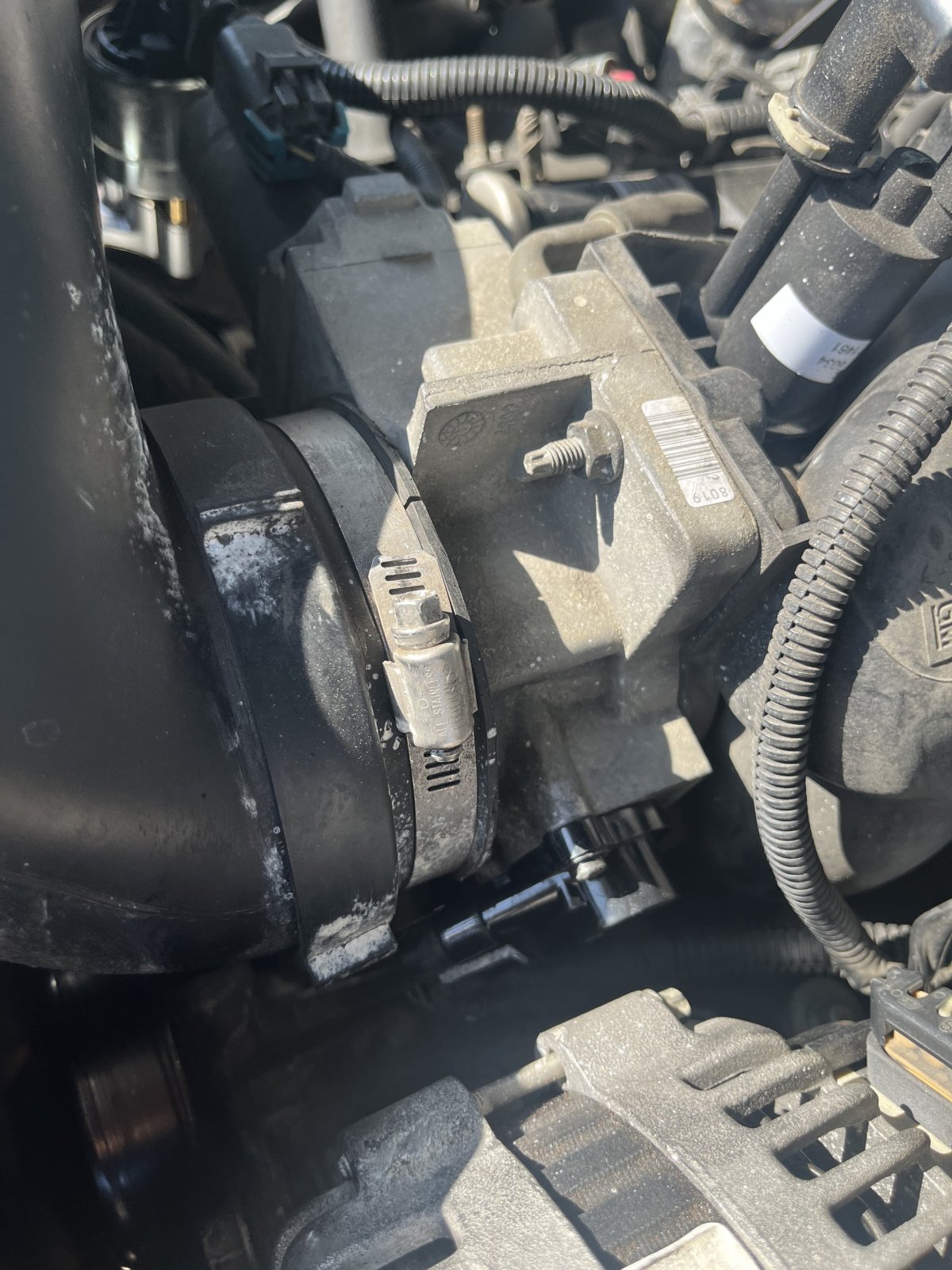

Okay here are some pics
30,704
48,353
if you had to force it open then it's possible, I would guess unless you can see something in there that doesn't look right and correct it then I don't know.
I would use a flashlight and see if maybe a metal tab got pushed and bent or anything like that.
