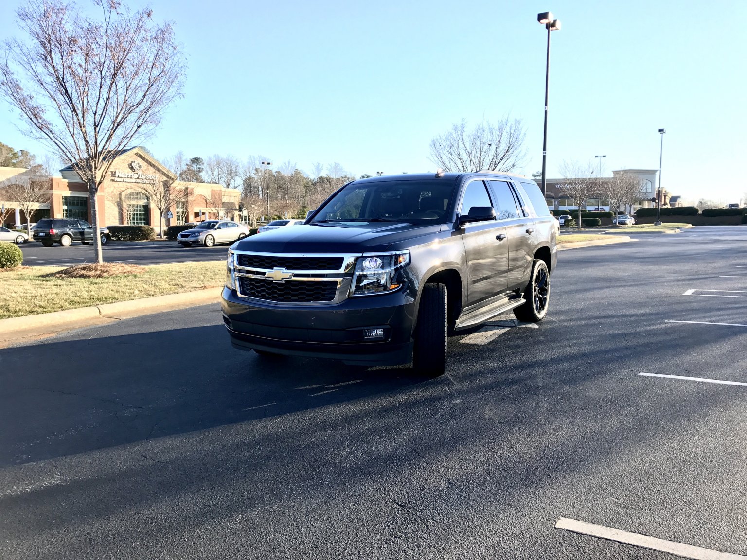

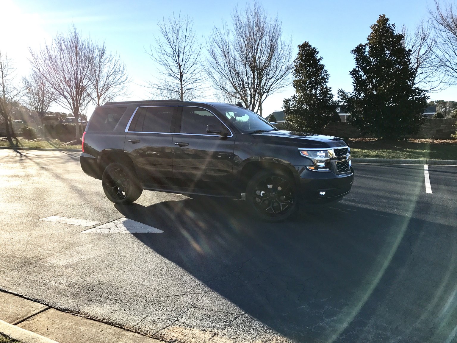

The tire is 285/45/22. It's a Chev set up. It is a brand new truck on showroom floor. If that wheel was offered in a 20" I'd be all over it.
I always preferred a stiffer ride(felt more controllable) but the Ltz ride of the 15+ is a little rough even for my taste. On a smooth highway they are great but on a little bumpy road (yuk). I think the best feature of the ltz is the hid headlights. If that was a separate option, I'd take an lt with autoride and the bells an whistles and call it a day
