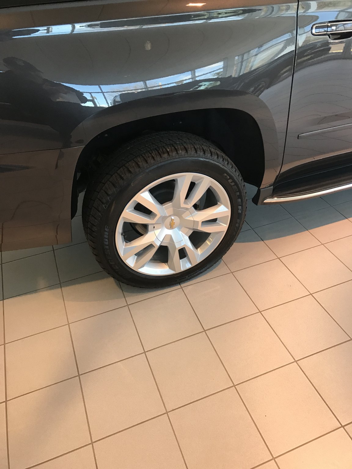

These are the wheels
AngelXL
Aug 26, 2016
539
253
What size tire is that? That looks like a really low profile tire. Small for the truck.

Most likely it's a 285/45/22 which I do think is to small for the truck... needs a 285/55/22

That might look better but the difference in rolling radius will make your speedometer (and odometer) non-trivially inaccurate. When the truck says 70 MPH, you will actually be doing 74.8 MPH. Here is the calculator tool.
I imagine it may be possible to have the computer recalibrated to understand the larger wheel size, but I am not sure how to go about it. It would be something to consider with a tire size jump that large, IMO.
The total rolling radius of the OEM 275/55/20 tires and the OEM 285/45/22 tires are within 1% of each other, so you could switch back and forth with no significant impact.

I have had both and currently I'm running denali 20" with factory size tires (michelin Premier LTX) mainly because we were dealing with the buffeting issues and thought the 20" might help. I've considered going back to the 22 but haven't done so yet. The 22" do look better but as other have stated I don't care for the rubber band tire look of the 285/45/22, especially on a truck. I think the 285/55/22 would look perfect but then you do have to deal with the inaccuracy.
