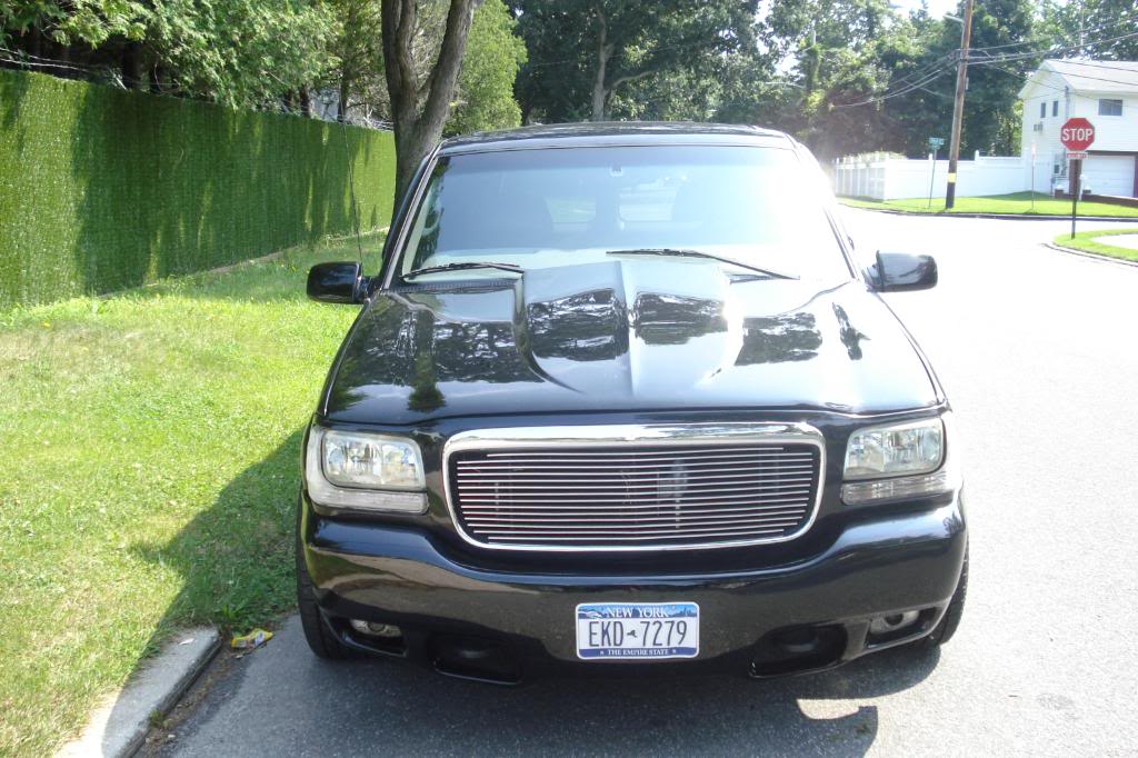

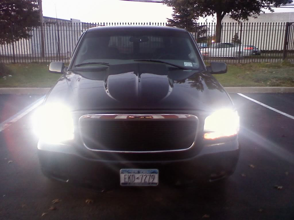

Taking Bella Donna to her first car show on Sunday. Well 2 n half hours worth due to I have work.
Today I painted my Billet Grill Black, De-Chromed my Boat Horns, & Mini Compressor and blacked them out.
I am really waiting for my rims to get back from Power Coat. If that happens I'll be PSYCHHHED!
BEFORE:
AFTER:

it came out really nice, painting the grill isnt that bad right, but it makes a huge difference

YUP THANKS DUDE!
Ended up doing it a lil different then you. But it came our *******!
foreverfalcon40
foreverfalcon40
May 3, 2009
2,082
how did you do it , just out of curiosity
Supplies 600 Grit Sandpaper
few clean shop towels
A Cleaner/Degreaser from an autobody supply store (needed to where chemical proof gloves and mask) I had niether...just mother nature. But I did wear long sleeves and doubled up on regular gloves
Adhesion Promoter
High Gloss Hi-Temp Engine Paint (its the only high gloss paint they had at autozone at the time
1) Sand it down real good
2) Wipe it down
3) Sprayed the Cleaner on and let it sit
4) I have a Compressor with a Air Blow fitting so I blew it dry and then wiped it down
5) Sprayed Adhesion Promoter
6) Then painted it like 4-5 coats on each side. I know it much but I'm **** :) and shit from mother nature kept gettin on there. REALLY NEED A BOOTH.
In b/w coats i let dry for 1-2 hours
Final coat I let dry for 3-4 hours
I did all of that with my boat horns and compressor too.
Its raining...I hope it holds!
Cost me like 14 bucks!

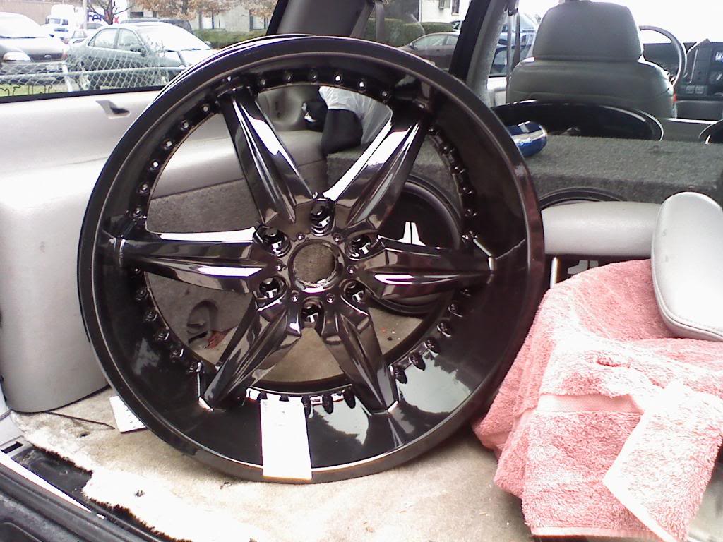

GOT MY RIMS BACK FROM P/C TODAY! SOOO FRESH!
Ran straight to the tire place when I had the chance today! Soo Sick...I had minor rubbing in the right rear but thats nothing a lil muscle couldn't fix! Really need my FOOSE centercaps to come in the mail from MHT and they'll be perfect!

Here are pics of the rims...they are from my cell phone. Hopefully better one's tomorrow or this weekend!
Happy B-day to me...on the 5th!
Pic right After I picked them up from Rainbow Powder Coating in Deer Park

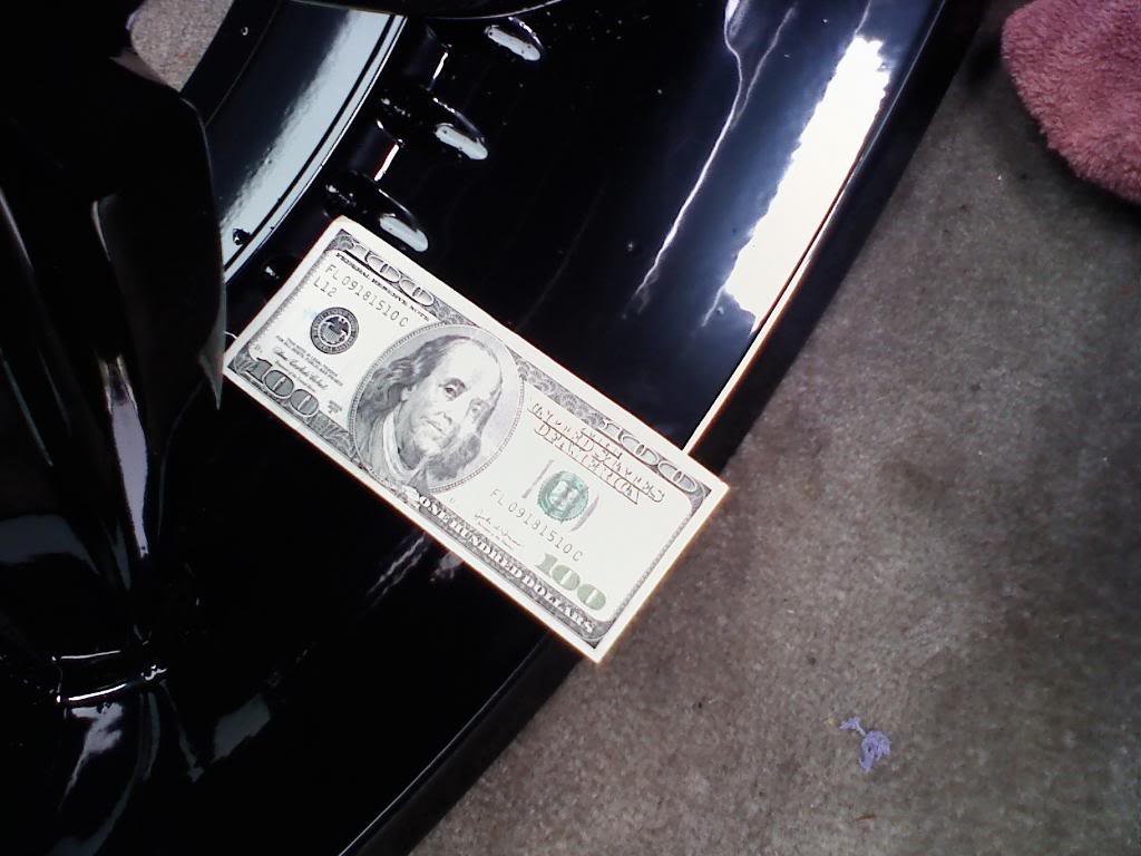

Deep Throatin Benjamin

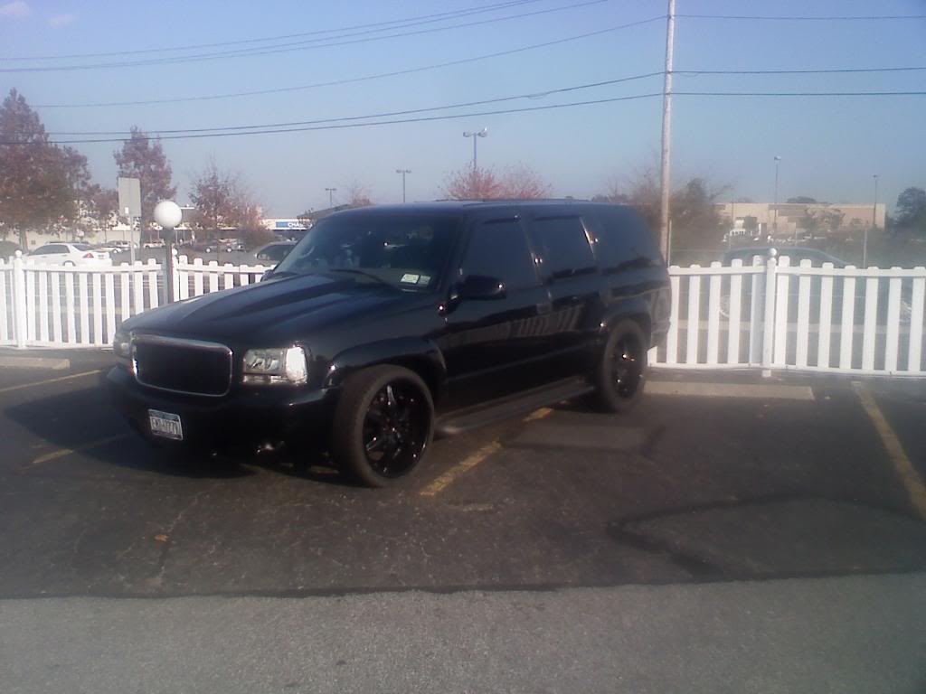

Installed!

I like the look a lot. You're going to leave the chrome trim around the grille and headlights as is right? I think it looks perfect as it is currently so I hope you don't black out the front any further. Nice job!

They do a lil, if you stand right above the truck it tucks underneath the FF. as soon as you go around the edges they stick out a lil more.

that is one badass truck sticking out or not ...mine is a day to day as money comes project but she'll get there i have zero plans of selling this truck in the next ten yrs so i got time.....
