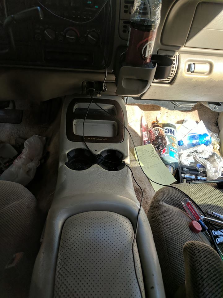

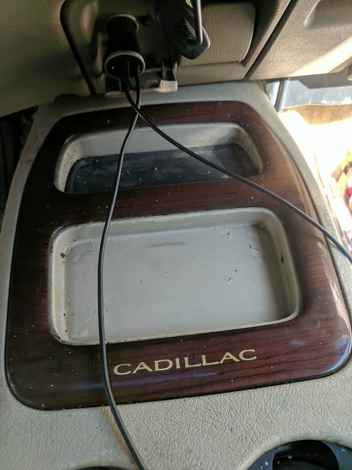

A week or so ago I dragged teh Caddy console out of storage and stuck it ( and a factory stereo) in it.
It still needs a good scrubbing, but it is better than the broken one that was in there.
I also made it faster LOL
I got all the Caddy parts on a trip to LKQ about 2 years ago.

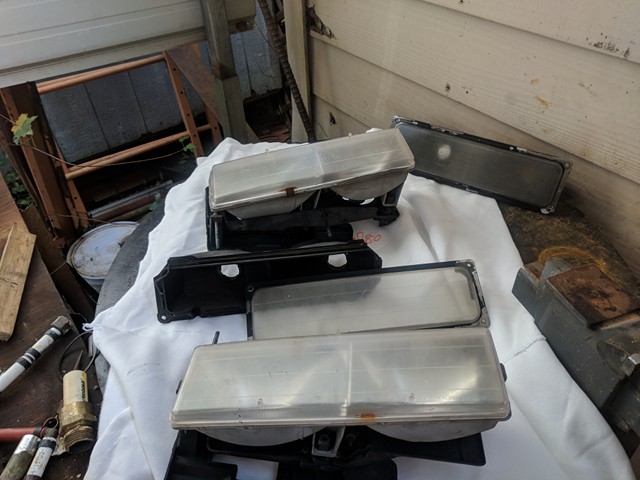

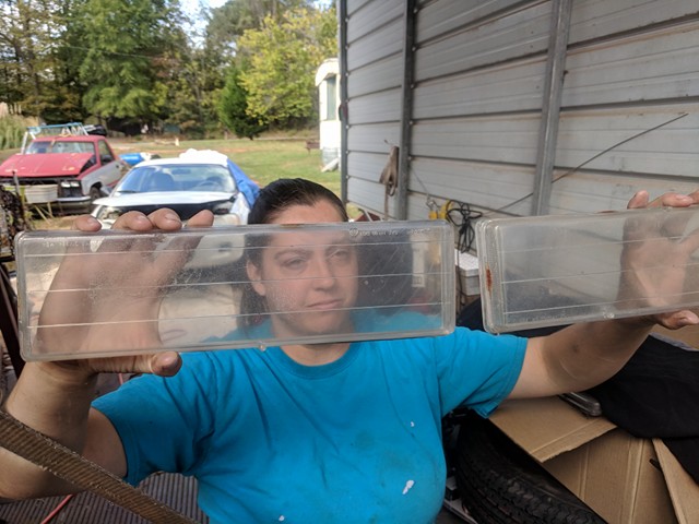

Yesterday I noticed one of the headlights was out. So while the wife and kiddo were at Chickfila I drove over to Pepboys and got one and installed it. I found the lenses for the headlight and turn signals were held on by good wishes. SO today we went out and pulled off the grill and yanked the lights.
I had Harbor Freight lens polishing kit so I put it to good use.
First pass
TheWarBeast
TheWarBeast
Aug 16, 2013
163
184

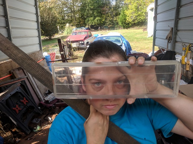

Final polishing.

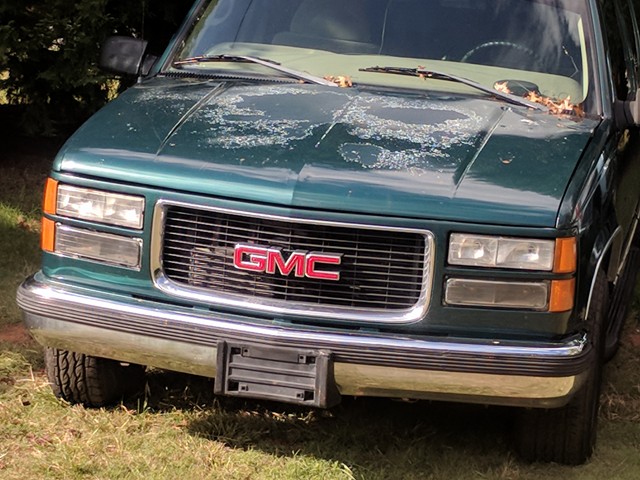

I got out the black RTV and put the lenses back on everything Then we stole some mounting tabs off a parts truck. For the first time all the lights up front work
Looks a million times better.

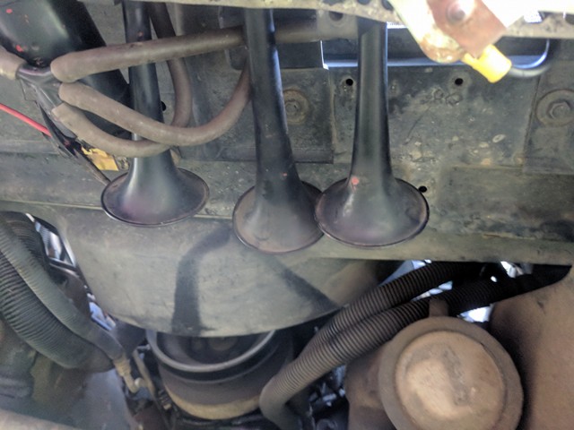

I was fed up with the puny stock horn so I put the horns we took off the S10 we just sold on it

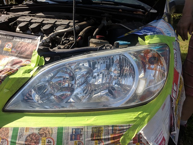

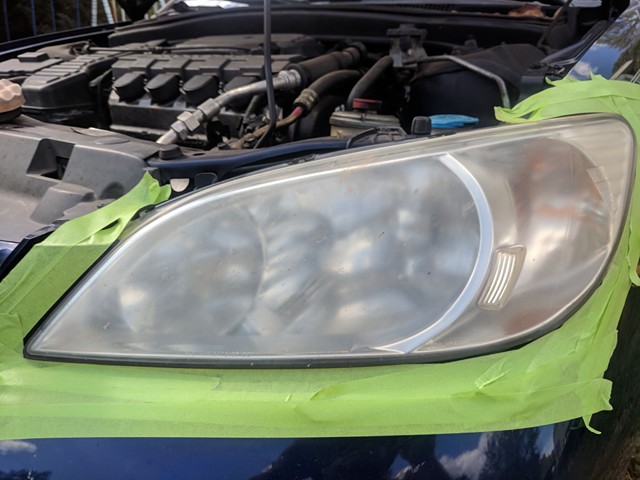

I also did my daughters Honda. I ran out of the HF stuff and found a 3M kit I got at a junk store. It is a million times better.

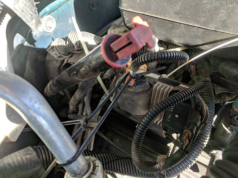

For the second time since I have owned it, she shut off on an on ramp. The first time it started instantly. I chalked it up to air in the fuel line or some other odd thing. So I got out in the deluge and looked under the hood, my nephew was nice and dry in the truck turning the key when I told him to.
After about 30 seconds it started. I had no idea what I had done. but since it was running, I got back in and drove on.
On the return trip we took a back way in, and in the middle of nowhere, it died again. Fortunately it wasn't raining this time. I coasted to a safe spot and got under the hood again.
After some looking I found that the PO had broken the tower off the ignition coil and put it back together with silicone and zip ties.
If I held the coil towards the passengers side it would start, as soon as I let go it died.
I got out my zip ties and used them to tie of off to the AC line and pull it over.

Tuesday we stole the coil off a parts truck and got her running again.
