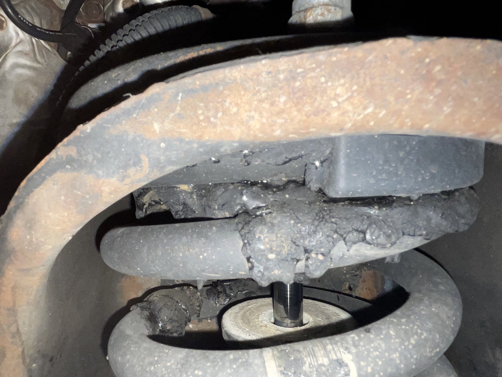

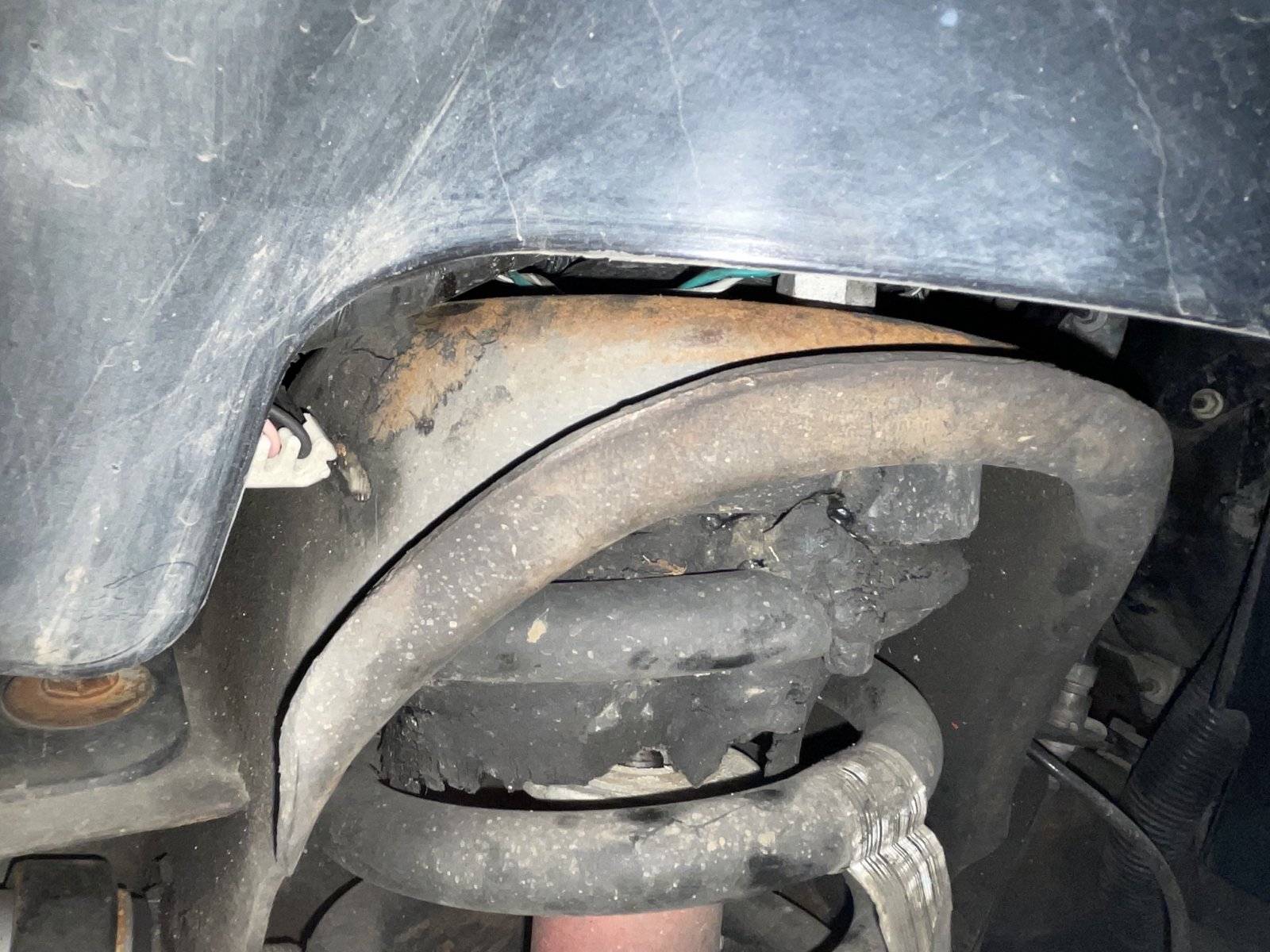

Hi guys, I am new to this forum as I just recently bought a 2011 Tahoe LT Z71 here in Panama.
Checking on the (all original) suspension I found a thick, tar-like substance that seems to be coming off the top of the front springs.
What is this and is it of major concern?
Thanks for any advice/comment.

That would not be normal, but the top of the shock in one photo is clean, so I don't think that it is directly related to the shock itself. Normally, there is a rubber dust protector sleeve that sits on the top of that assembly facing downward that shields the shock's piston from foreign materials. I can see the remains of one in one of your photos.

I think there are some rubber isolators on top of the coil spring. Maybe they have melted for some strange reason? IDK

Yeah, the engine bay is super clean. The previous owner had the whole car washed regularly and thoroughly. Looks like the degreaser could have destroyed these rubber boots. As I am looking for a mild lift kit (max. 4") I will have the suspension checked anyway.
Are these rubber boots necessary and should I look for replacement?
10,315
14,938
The rubber boots keep dirt particles from getting into the stock's piston and damaging the seal. Yes, you should have a boot to protect against this.
