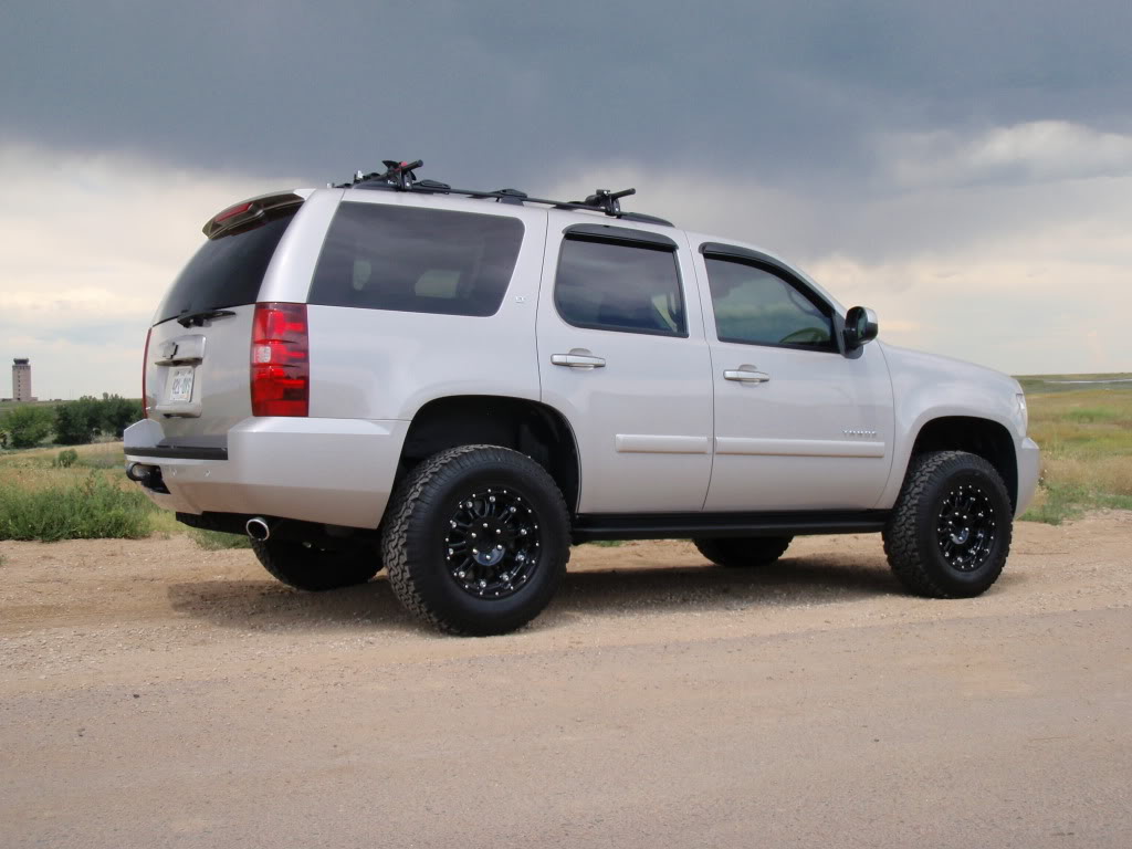

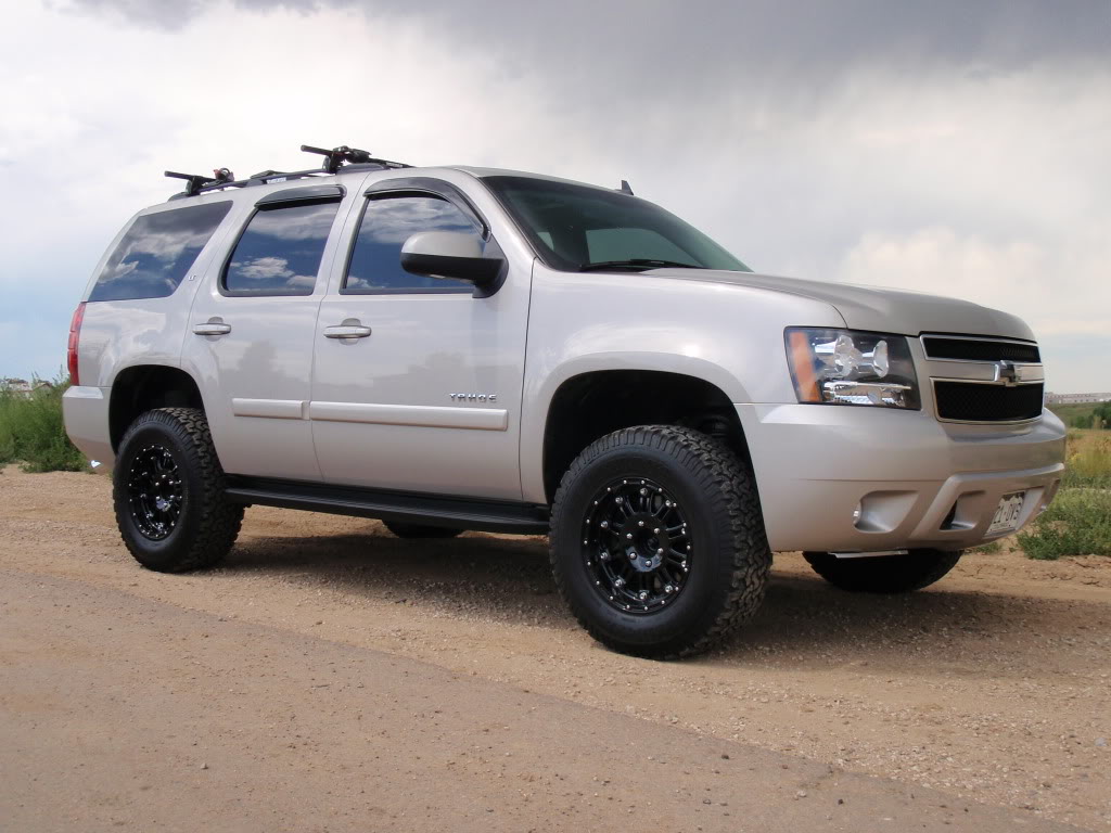

TRUXX front and rear leveling kit:
285 70 17 bfg at's on 17 x 9 wheels.
The install is doable with a couple people, but if you have access to a lift (rather than jack stands) it will be much easier.
You'll also have to get the knockouts from the dealer to do the alignment.

07 Tahoe Z71 w/Bilstein leveling
Goodyear Duratracs (275/65/18) on stock Z71 rims. Bilstein 5100 front leveling shocks.
