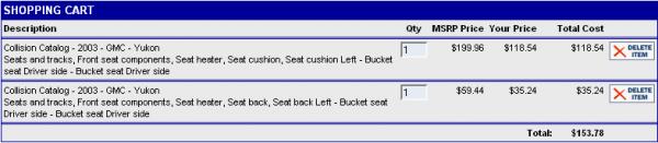

I'm pretty sure this just happened to my 03 tahoe and I think I've narrowed it down to the driver seat cushion heating element. I've done some searching but can't come up with a part number. Does anyone have one? Do you think one from a similar year escalade be the same?
I might dive in a little deeper one night this week and see if it actually looks scorched or anything.
