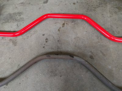

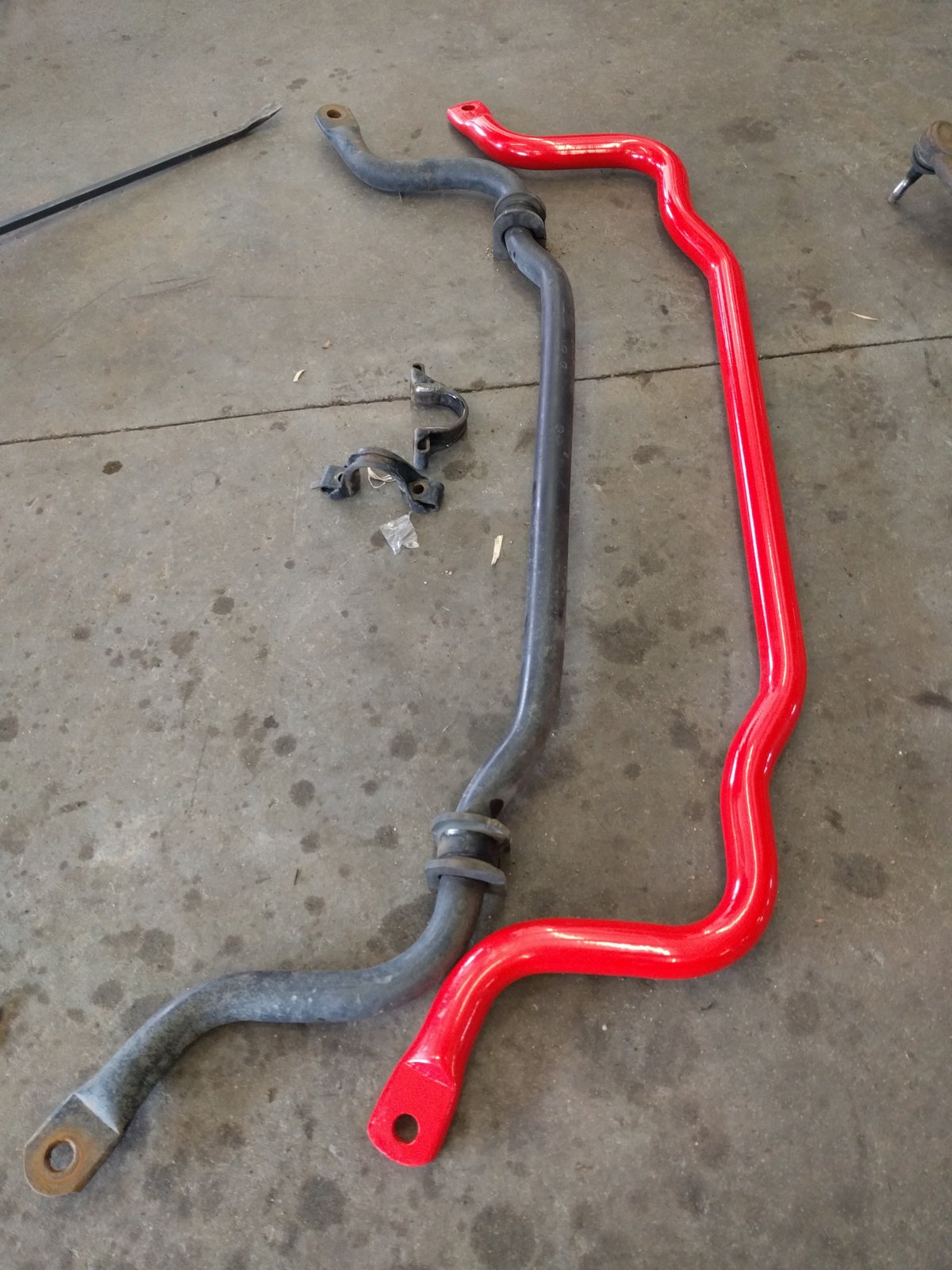

I ended up getting eibach bars after all, I found they do make a 1.5" front bar and the 1.25" rear bar. Going to install them today, as well as replace every suspension compoment it has. I think I'll start a thread in the under construction thread and post pics of the operation. I can't wait to see how the new sway bars work on this beast.

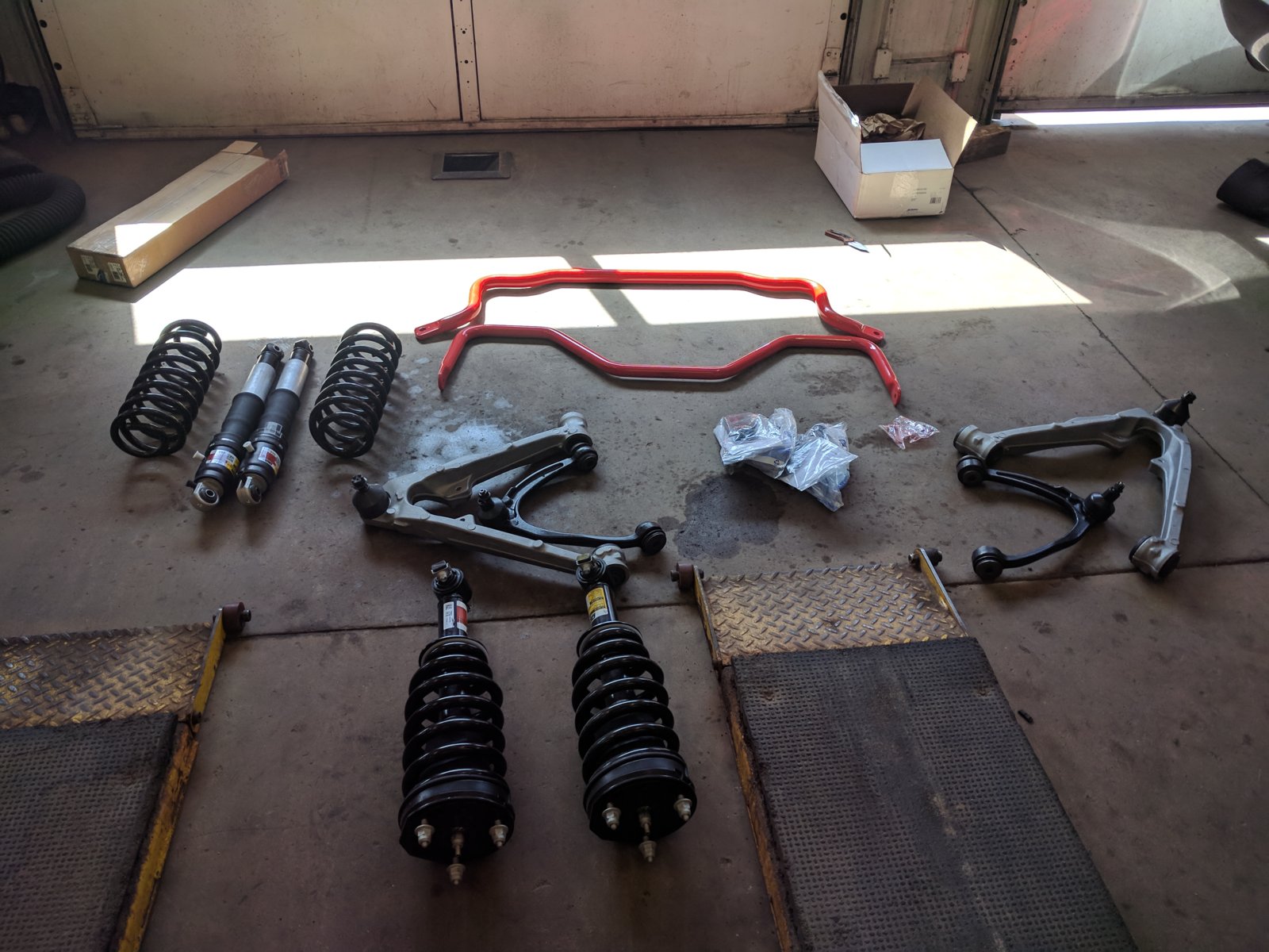

The pile of new parts we put on today, a few more pics to follow tomorrow. It's been a long day, but wow is what I think so far of the new sway bars!

Why rear Springs?
I replaced them because I figure alot of weight has been sitting on those springs for the last 8 years and they had to deal with worn out shocks for the last few years. I was already replacing the shocks, figured I'd just replace them now as well as cheap insurance. They were $60 from rockauto, and with going off road and camping, it gives me piece of mind. Maybe I'm a tad OCD too, haha

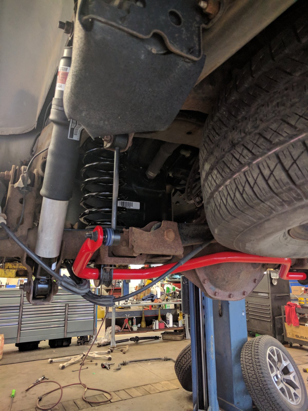

The picture with the rear put together, I snapped the picture BEFORE I tightened up the rear sway bar to the axle bolts. I KNOW one of you guys will see that and yell at me, haha

I checked Hellwigs out, and their front sway bar is the same size as the Eibach one, but the rear sway bar was bigger with Eibach so I picked them. It handles so much better, it's night and day different. It's especially fun on the highway.
