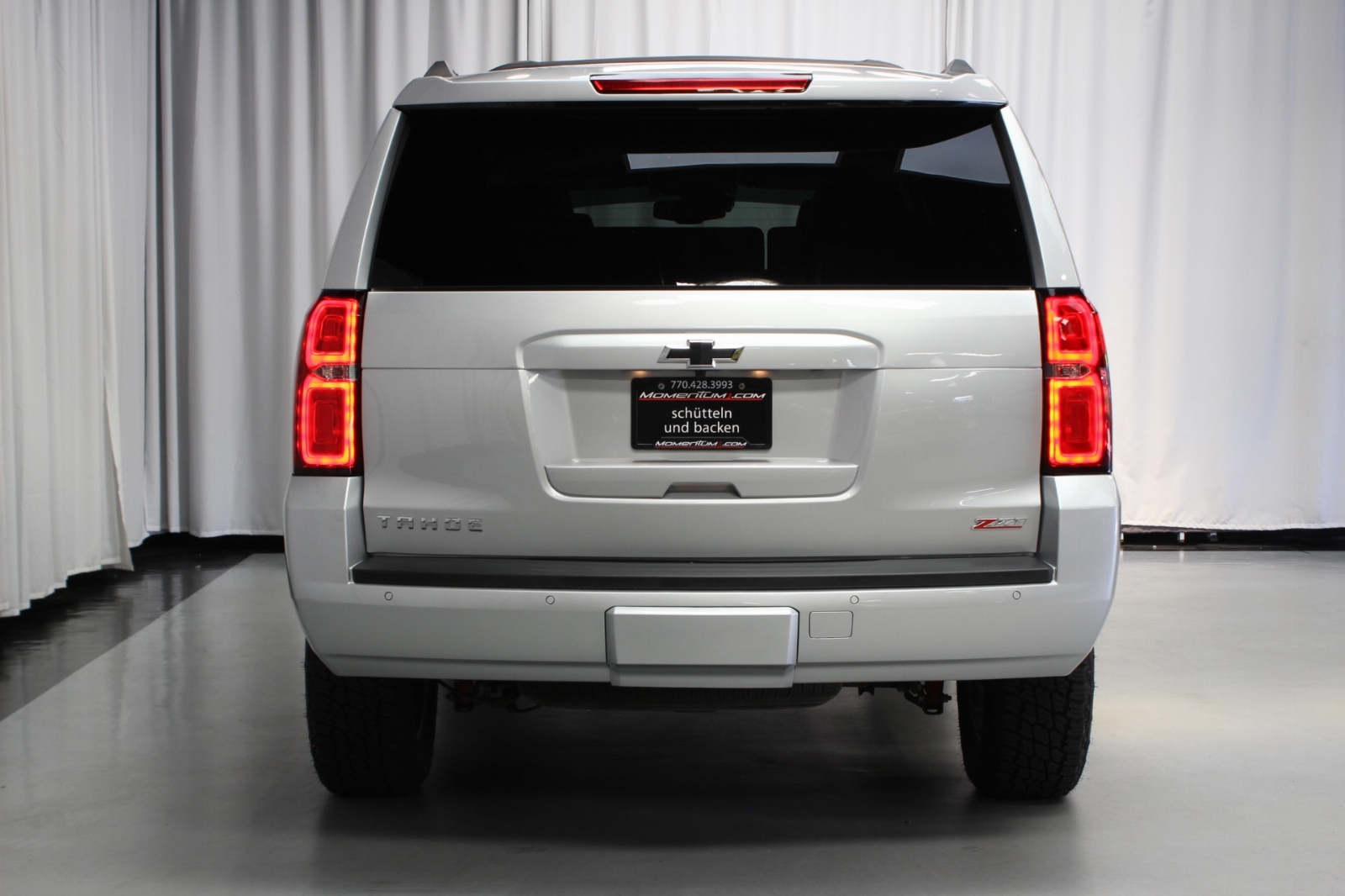

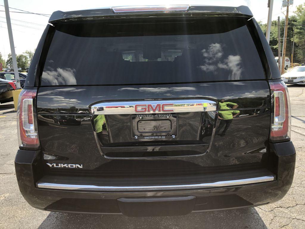

Tahoe brake lights and turn signals are together, is that correct? The Yukon has separate turn signals and brake lights, which double as marker lights. On the Tahoe I believe the marker light does not act as brake light.
EDIT - was behind Suburban today. Each tail light has 2 incandescent bulbs, which double as brake-turn-tail. The LED "perimeter" light is only for a night time marker light when the headlights are on.
The Yukon has separate brake and turn functions. You'd have to search for an adapter harness or build one yourself to be able to do this properly and get the lights to work as they need to.
Also by the way - if you swap out the tail lights from Yukon to Tahoe/Suburban, you'll also need to swap the 3rd brake light. Chevrolet tail lights are all red including the third brake light. The Yukon lights have a clear outer lense and red inner lens for both the tail lights and 3rd brake light. I assume you'd want them all to match accordingly and properly.

That’s sucks because I’m definitely not trying to build anything. I hate the chrome infused Yukon taillights and have not been able to find an aftermarket one without it. It’s gonna bug me to death until I’m able to delete the chrome in the light somehow. Maybe I will have to open one up and modify from the inside.

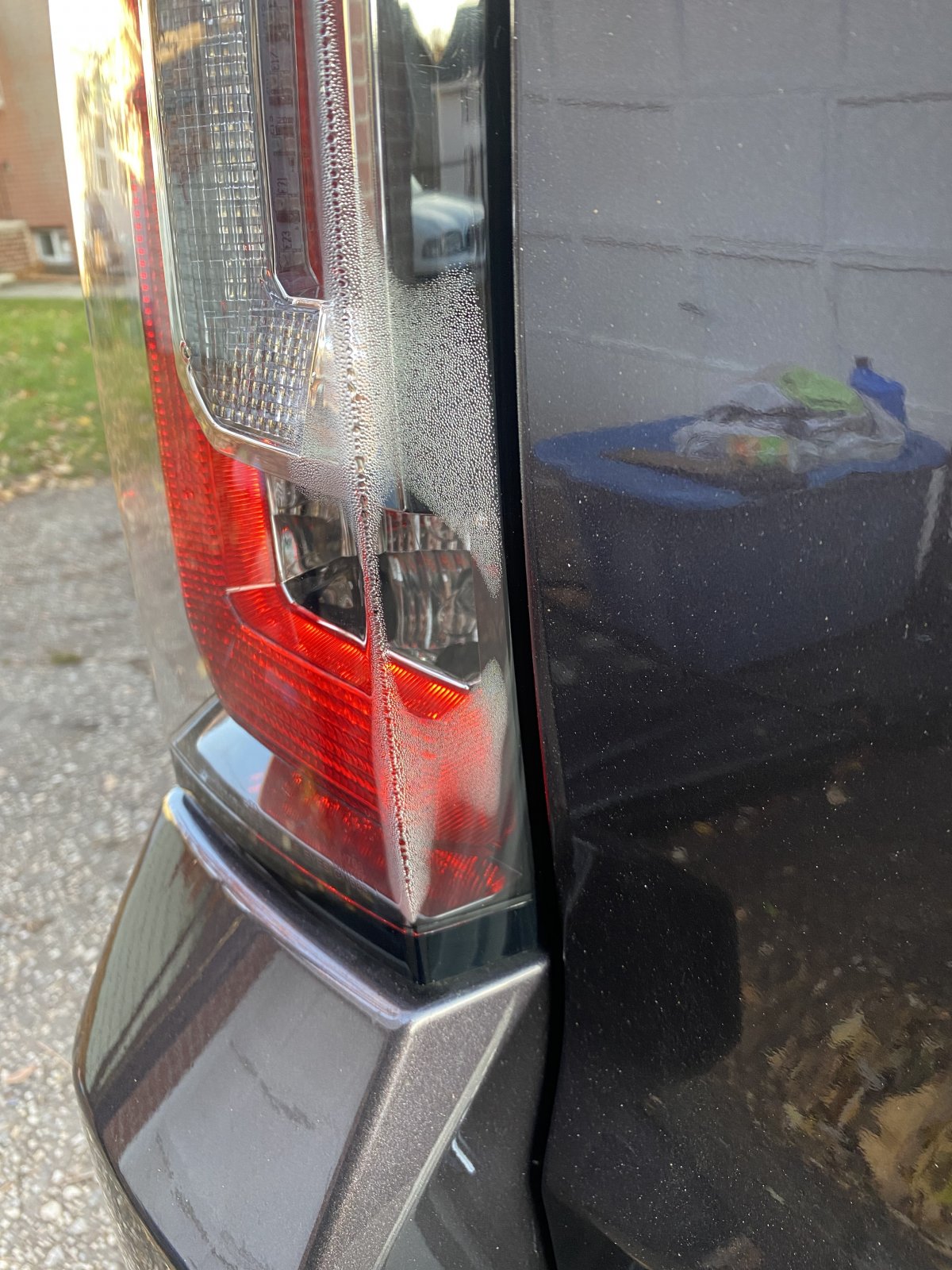

Looks like I’ll be opening up a tail light sooner than later. Swapping harness seems doable to swap the light based on my observation but forgot to take a pic. Got a foggy driver taillight and it’s been garaged and not wet for a week.
I noticed that when I bought used almost 4 years ago - I had them both replaced immediately under warranty. Haven't noticed condensation in the headlights yet thankfully.

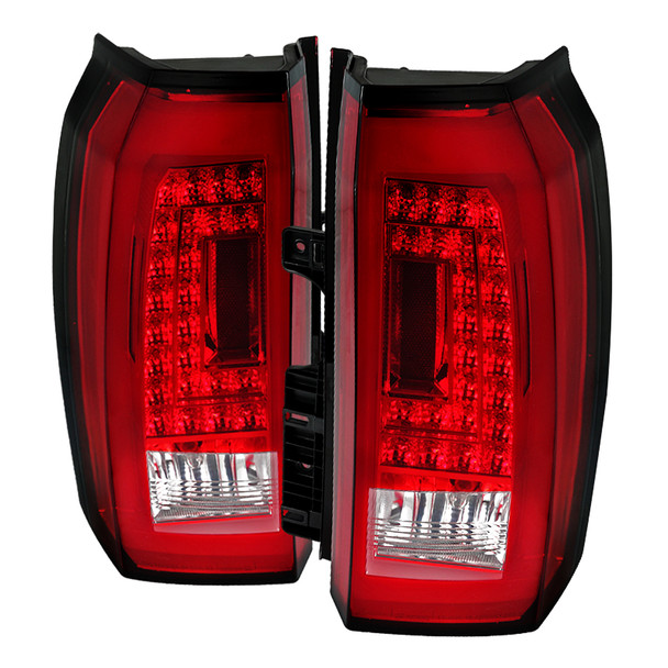

Well Lamin-X sells thicker red sheets and I thought I'd buy that and get a pro to do it. I know that the reverse lights will still shine through white, I had a 911 with euro spec tails all red and the backup light section was a little lighter red but white came through. I want the stock look but the red lens will be killer.
At one point I considered these Spec-D crappers but I just know they will condensate and somehow cheapen the look of the truck.
https://www.headlightrevolution.com/goretex-patches-A-GORETEX_2?quantity=1 someone posted these earlier and might be a way to fight the condensation. I just ordered a set and will try it out on my taillight. I like the look of this you posted.

Well the way to do it is when they’re brand new put them in the oven to warm up the glue. Not sure the temp or length of time but the HID retrofit guys or sites have the answer out there. Then carefully pry the lens off and clean the crap they seal it with off. Then reseal them with high quality butyl material to seal them up again. It’s the stuff OEMs use to seal headlights; the good stuff. After that should be okay. I just don’t have the time or energy for something like these days.
