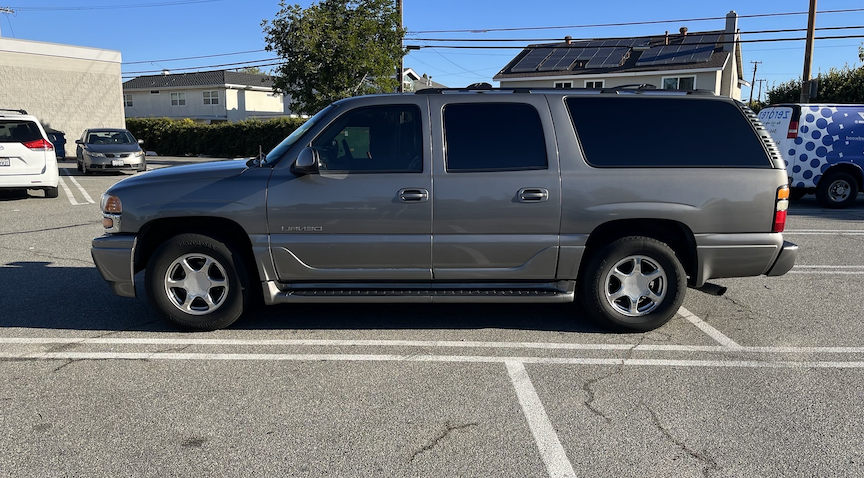

Hello Everyone, hope you all are well.
I have an 06 Yukon XL Denali with stock suspension, I have very little experience in suspension besides some basics.
I like the height and wheel setup for this rig and would like to do something similar. https://www.trailbuiltoffroad.com/w...lack-rhino-stadium-rough-country-leveling-kit .
My questions are,
Do I need to purchase the leveling keys mentioned on that website or similar, or can it be done with stock keys ?
What do I need, if anything, to do with the rear?
The profile mentions they did a little panel cutting ,I don't what to do any of that. I just want to raise it a bit and get some new rims and tires. I don't want the tires to stick out too far out but if it's better for stability or safety I would do it. If you have any recommendations for a better setup regarding any of this, wheels , tires, suspension components, please advise.
I attached an image of my rig and of the one I'm looking at just for reference, there's more pictures of the rig on the link above.
Thank You for your time!

Rubbing can also depend on the condition of the suspension before the modifications. A fresh suspension may not rub while a 15 year old original is going to sag some.
The keys will restore the ride, cranking stock keys results in a loss of how nice the truck rides.
You might consider a 285-70 tire in either 17 or 18 inch wheel if you want some height. I don't know what the typical offset used was for your generation. For the one after yours, 31mm was typical. So 12mm offset moved the wheel about 1/2 inch outboard and with a wider tire can induce clearance issues.

If your current suspension is working properly, your truck should be leveled. If you raise the front end, you should raise the rear end as well, or it is going to look a bit silly, and won't handle as well.
If it were me, I'd stay with the stock wheel profile (width and offset) in a wheel that you like the looks of, and then look at a wider tire with a lower profile to keep the overall tire height more or less the same as stock.

If you were lowering it, I could be more help. I don’t have any experience with lifting these trucks. With that said, I do know the rear ride height sensors will need to be lengthened if you lift it and you want to keep the compressor, stock type rear shocks and self leveling or else the computer will think it’s already too high and the shock bellows won’t fill.

Sorry for the lateness of my reply. Just now seeing that I was tagged after finishing giving my rig an oil change. @1xd5 Looking at the photo of that red Denali xl that you posted beside your truck and reading the thread that you linked, it appears that the owner of that truck didn’t just swap out the factory torsion keys for leveling keys to achieve enough lift to fit that tire setup. There’s mention of Z71 coil spring swap, which lifts the rear of the truck up for sure, from what I’ve read on others member’s lift threads here. The thread also mentions rough country shocks so I’m assuming longer shocks were necessary. Doesn’t say what shocks but I’m guessing he deleted the Z55 suspension setup with the rough country shocks.
So quite a bit more in depth since leveling keys alone won’t lift the truck enough to fit that big of a tire on stock suspension. To also add to the info in this thread the factory does setup a mild rake to the suspension. At least with the GMT800s they were definitely not level out of the factory. The front is set a tad bit lower than the rear, from what I understand to help with aerodynamics and fuel consumption. I can say for certain this is how my truck was setup on stock suspension.
The leveling keys will lift the front of the truck a tad bit higher,
I did that to my 2006 Denali xl. Not sure what brand keys were used but it brought up enough to fit a 275/65 Michelin LTX A/T2 tire on my truck a couple years ago. Running a different tire setup now but still have the leveling keys.
