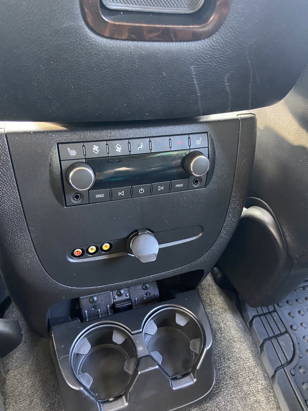

On star is back now. Any idea how to access the hvac controls?
That surround piece has clips, you need to get a trim tool in around the edges and pry out carefully around the perimeter until they pop loose. Then you’ll see the screws that hold the control in. You should either disconnect the battery or just make sure not to turn the key on while the control is removed.

UPDATE: Everyhting came back to life & is holding up. Had the rear A/C control replaced at the dealer (they said it shorted) $632! Now working with the car wash for reimbursement. Hopefully they don't make it too ******* themselves.
