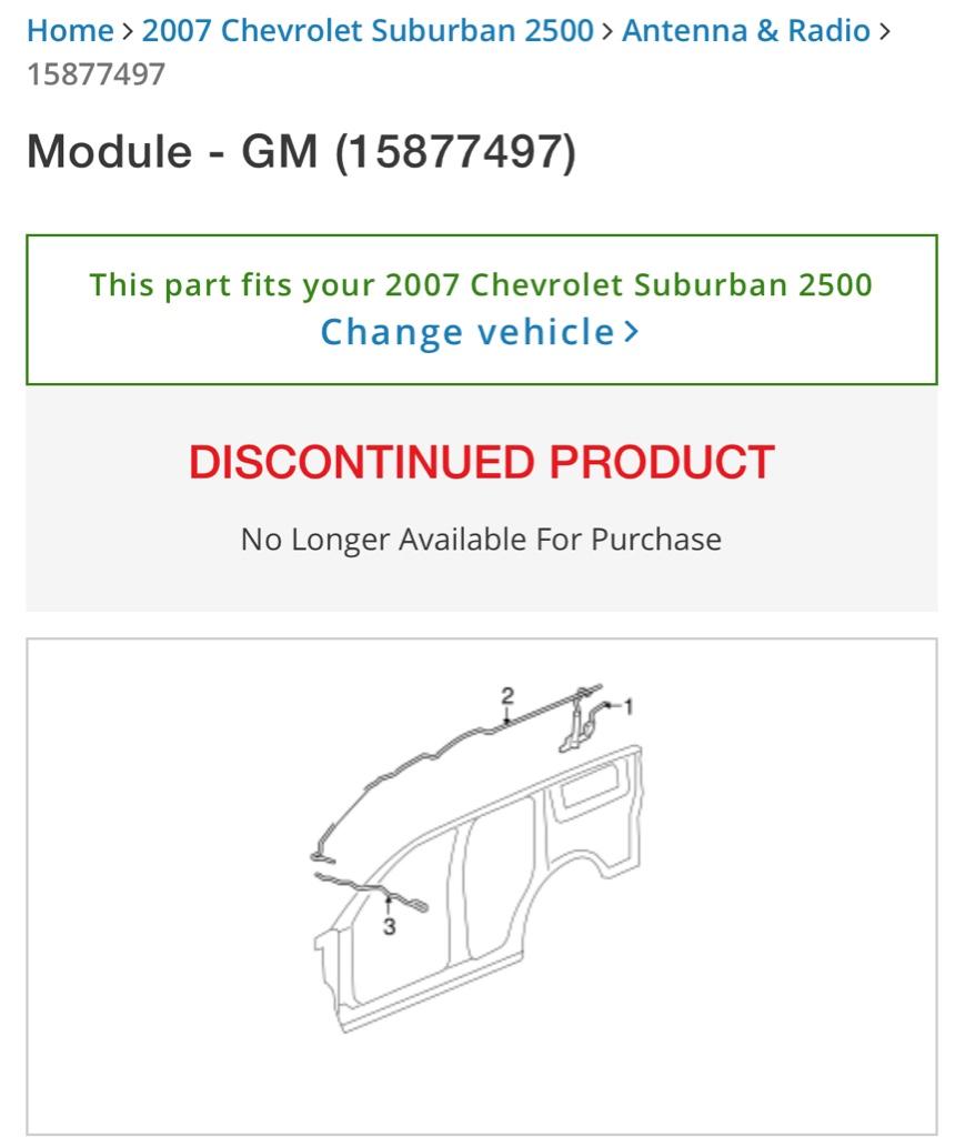

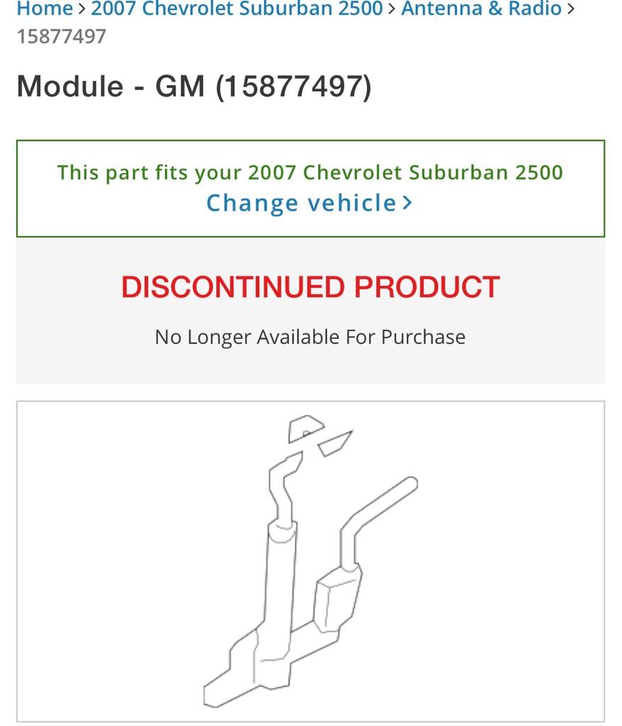

It could also be the module above the back window as well. Seems like your going to need to troubleshoot like others said. Here is the part that may be in question.

Thanks for that diagram, that's pretty useful. The way it's looking though, I may just pull the radio out and throw in an aftermarket antenna at this point. If the part is no long available and there's a chance that the tint is causing problems, I don't think I'll even bother with it. Thanks for time, info and help guys.
