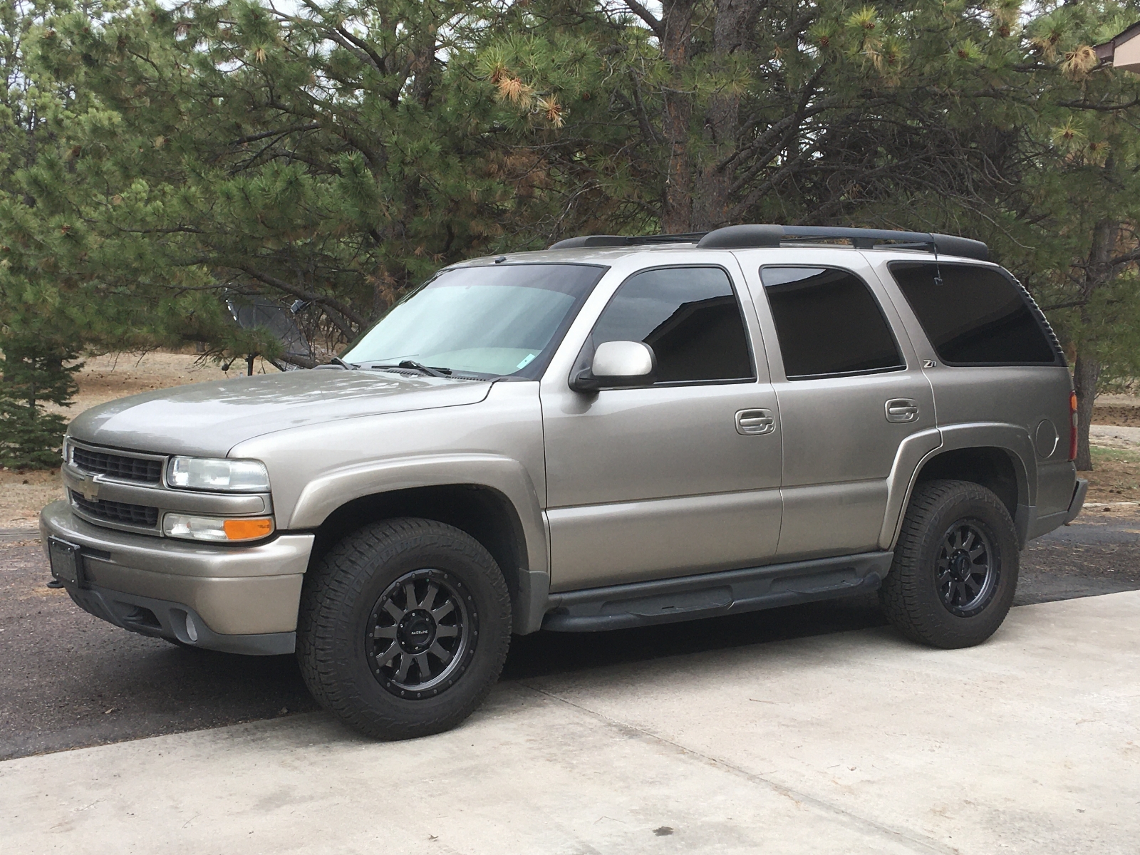

Here is my ride as she sits:

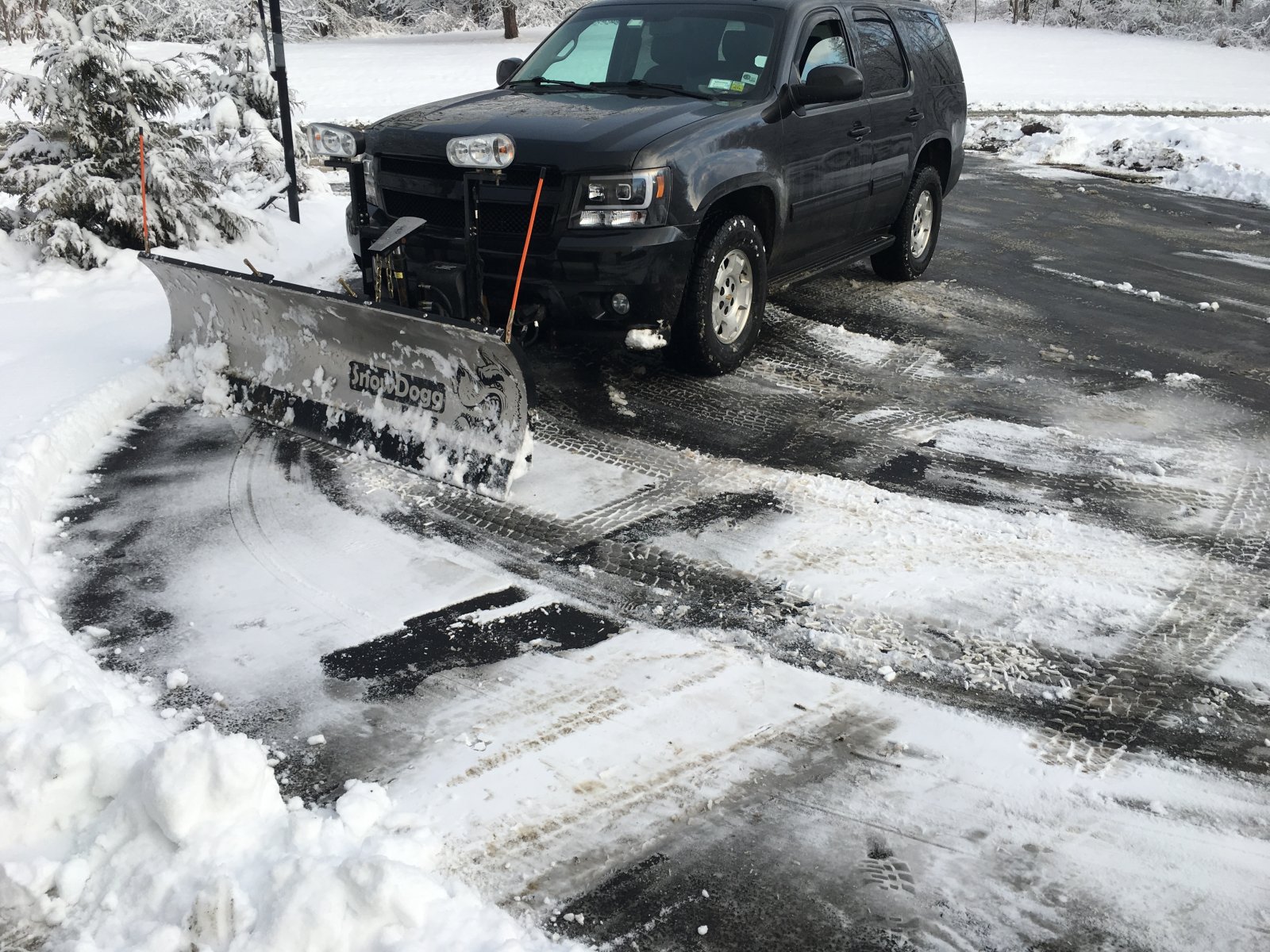

Had one on my 01 and transferred it to my 13
Both stock, i cranked the stock keys a little on the 01 and added timbrens... also had bilstien 46’s and very little to no droop. Timbrens are the best thing you can do. Truck rode just like stock with and without plow. Add couple bags of samd to the rear when plowing and you won’t even feel the plow
13 is all stock.
I do the same .. long private drive only and occasionally a friend neighbor.
Remember these are 1500’s get lightest plow you can... all this said it beats the crap out of the hubs so replace them if you haven’t already.
I put a snowdogg md75 on and it was probably the easiest plow to mount ive ever used and ive been in the northeast plowing since before i was legal to drive, very little trimming to the bumper and a light plow.
