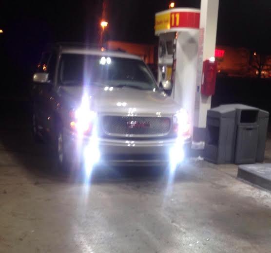

im looking at the u2-55 24 inch tire i really want the wide 305/35/24 tire. I measured my fenders because I think my Denali sits low and rear fenders are at 36" 1/4 and fronts sit at 35" I really hope they do fit without rubbing the offset is +30 if they do rub is it just minor? easily fixable? and how low can i drop it until i run into rubbing issues using the 305/35/24?? Thank you in advanced guys.
the other picture is how it looked when i got it looking at the fenders it looks like it was lowered or am i wrong?

Rear looked low and air ride was not working so i put in stock springs and it lifted the rear. this is before the springs.
