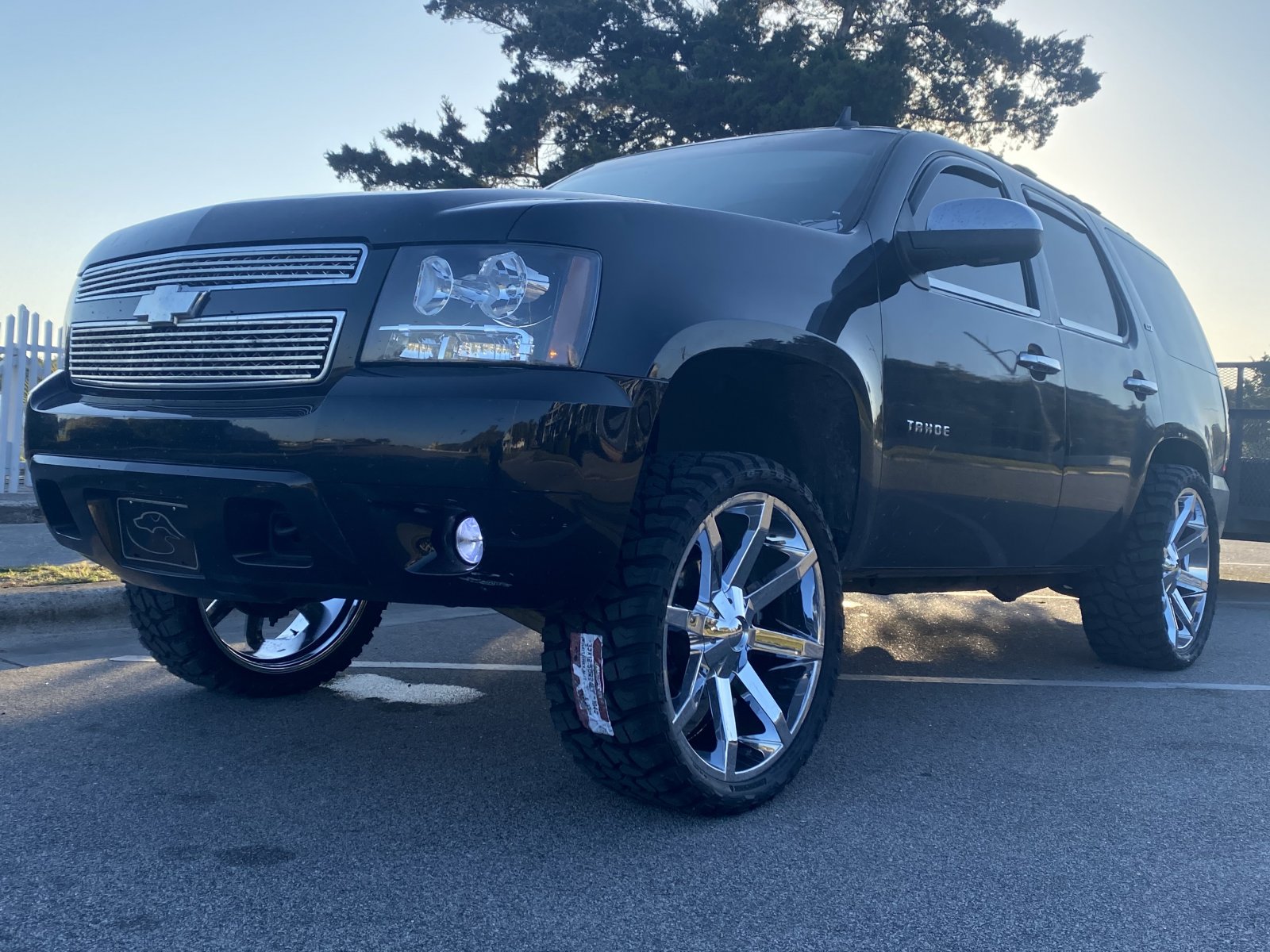

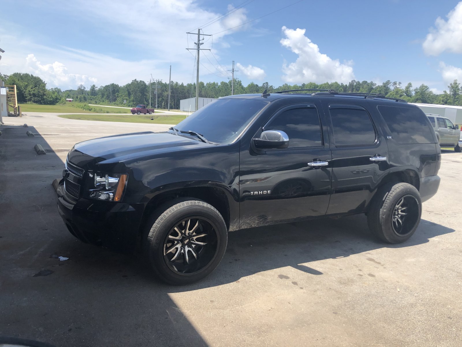

When I got my 07 the first thing I did was throw some 20x12 on with 275 streets with no lift IMG_2147.jpegI was running 2” spacers all around that’s why there poking so much but without them they were just outside the fender well I cleared full lock with 275 streets on them
When I stepped up to 33/12.50s I had to run a 2-3” leveling kitIMG_4636.jpegafter the 20s I ran some 24x10 kmc slides on 33s and cleared no problem with the 3” lift and wheel spacers IMG_4797.jpegthis is all I ran while on the leveling kits I stepped up to a 8” lift with x14 wides after this which isn’t what your going for I’m assuming
