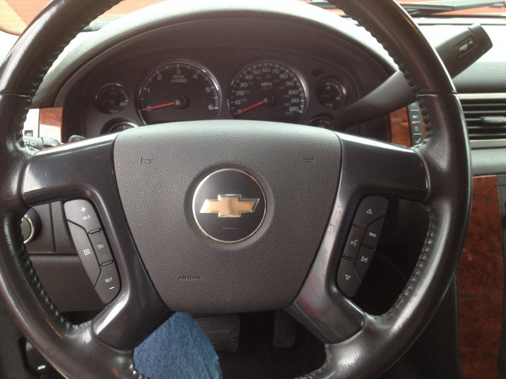

In the picture the coating is very thick. Mine came of super easy. I was in a drive- thru with my debit card in hand. I scraped it where it was already coming off, and it came off really easy. The coating was not nearly as thick. But the results are good and price in my case was zero.

I did mine for free... When I bought my 07 a few weeks back with only 70K miles, I noticed the same pealing... it was driving me crazy, so every time I went for a drive I would take my thumb and I wore off all of the matte rubbery stuff... It looks way better than it did, and it cost me nothing. The skin on my thumb got a little sore after a while, so I would quit until the next day.
