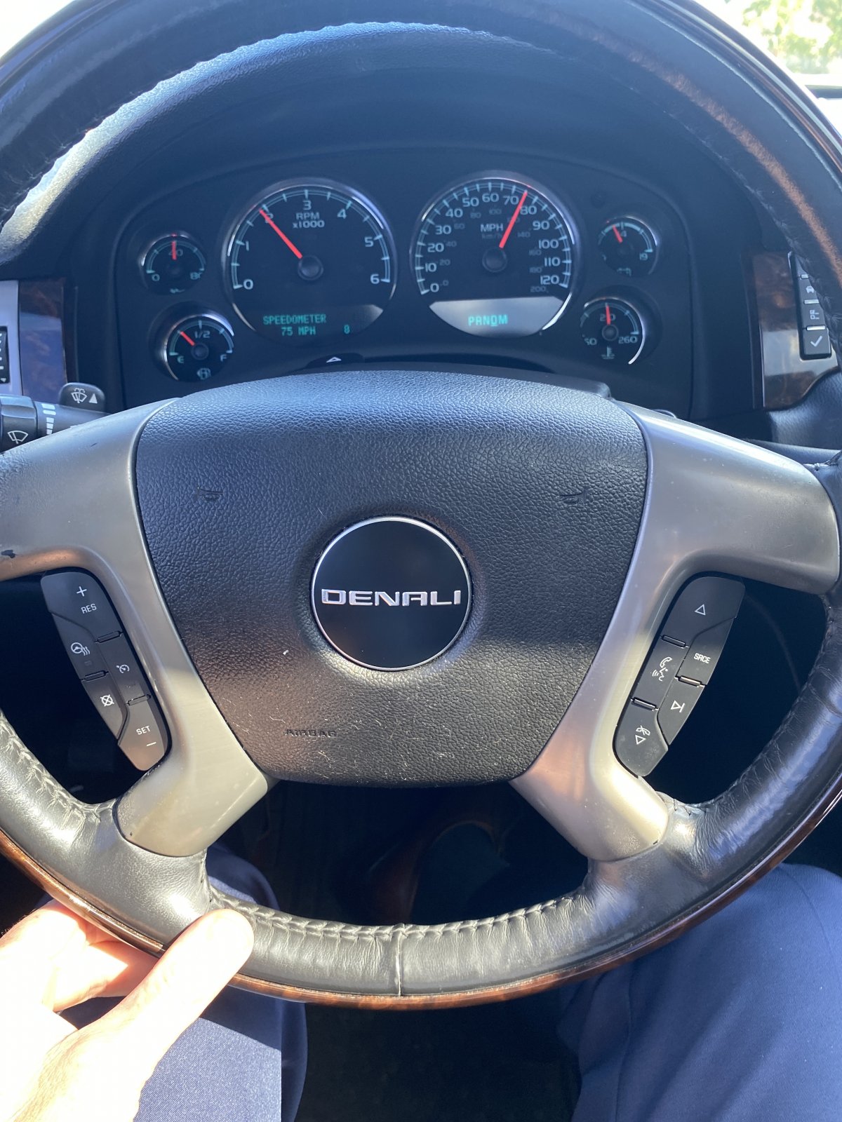

12 Yukon Denali all steering wheel controls quit working except for the heated steering wheel. #3 fuse on the side of the dash is for steering wheel backlight. I don’t see any other fuses for the steering wheel. Anyone experience this that can advise where to start?
All not working:
Volume up/down
Source
Track up/down
Call/mic
Cruise control buttons

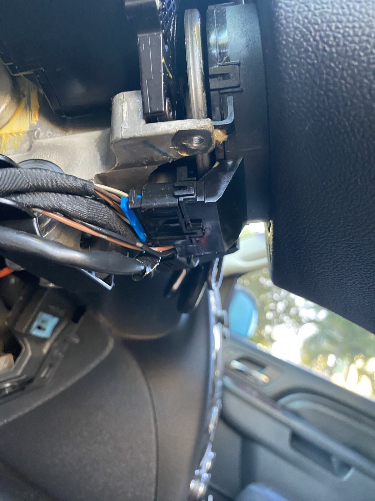

All fuses were unfortunately ok. The wiring at the column seems clean & connected. Took a few shots for reference. This is entering an area about my pay grade. Going to seek help.

I see some electrical talk and shrink wrap on some of those wires that doesn't make sense to me. It's been a while since I've been in there on one of these so maybe that's factory, but it seems odd.
