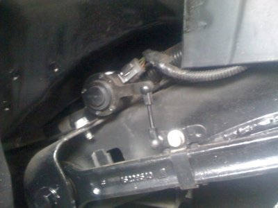

Depending on how much lift you have in the rear, there may be an issue with the autoride guide rods. This is my opinion based on the issues from others dropping the rear. Attached is a picture of the sensor rod. For the drop, the rod was shortened and re-threaded. I would assume, for a lift a longer rod would be needed. Hopefully those that lifted the LTZ model will chime in.

I had my 07 Escalade lifted and it did not need auto ride adjustment at all. I even called Truxx to ask them if it was needed. I spoke to another guy that had 3" lift on his 08 Caddy and he did not need to adjust autoride either. LTZ is the same
