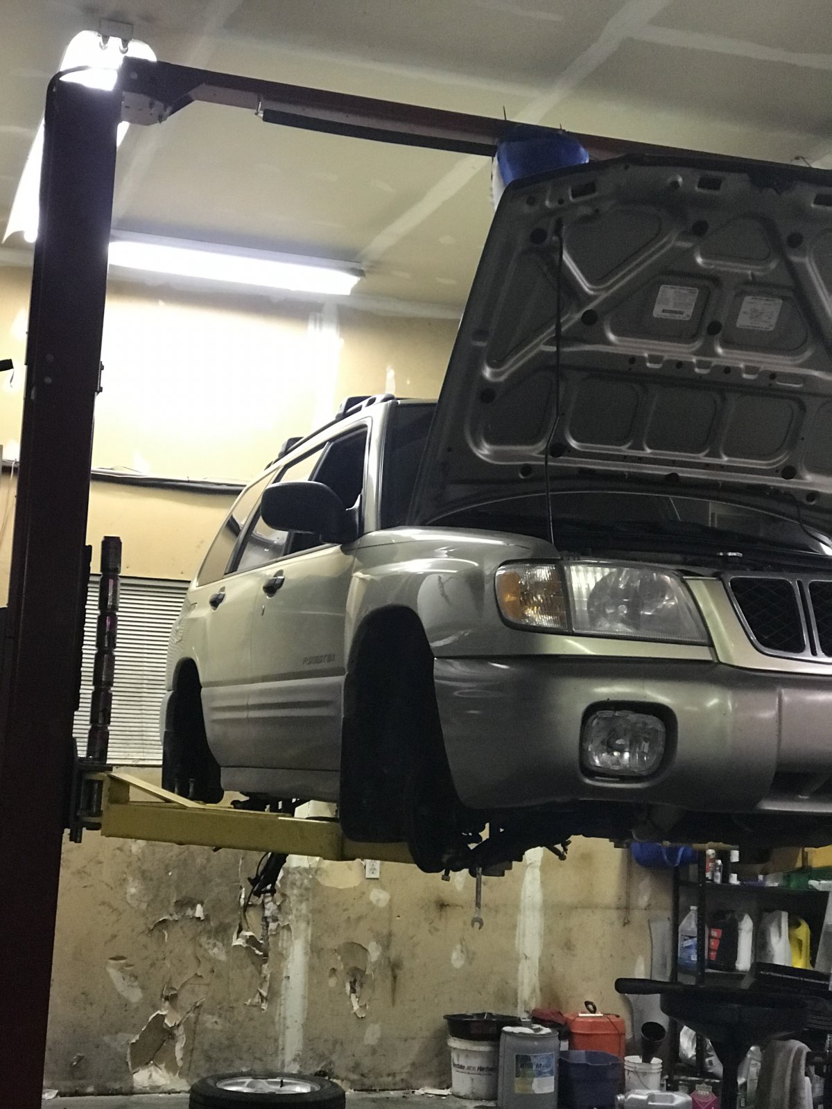

I had a buddy who inherited a house with a garage addition that had an 18ft ceiling and a 20k lb 2 post. That was the LIFE. He ended up selling it and moving to GA, where he now works for a race team. Pic of my old DD SF Forester on his lift.
