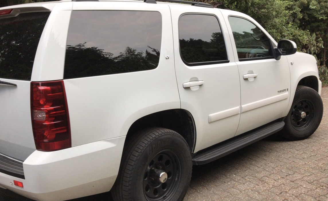

Hello Guys
I have a tahoe 2008 with soft8 hole alloys and since i fitted them i have vibrations from 70-85mph.
Gloss modular soft8
17x8
ET10
110 center hole
But even with centric spacers from 110 to 78,1 the vibration stays.
265/70/17 Tyres on them
Do you also have this?
Is it tyre related?
Or are there better alloys with the same style and no vibrations?

Tried it without the centric spacers so they are only centered on the 6x bolts.
Then tried it with balancing again
Then tried it with weights stuck on the outside instead of glued weights
...all the time vibration around 70mph.
And nothing when i put the 20” wheels on There.
But they are 78,1cm centerhole

Found the issue.
The soft 8 hole alloys where not flat where they rested against the hoe’s mounting plate.
they rested on a weldline that the alloys had on the outside of the rims part where it rests agains the hoe.
And the welded circle was not nice and flat all the way round.
Think these alloys are originally made for cars that have a smaller mounting plate where the alloys would rest against, inside that welded circle.
But on the hoe the plate is bigger and therefor doesnt sit nice and flat against the wheel.
so i had a very thin spacer made which is thicker on the inner side and therefor rest inside the weld line. And thicker on the outside so it creates a 100% flat circle on top of the weld circle.
Now i have 0 vibritions :).
