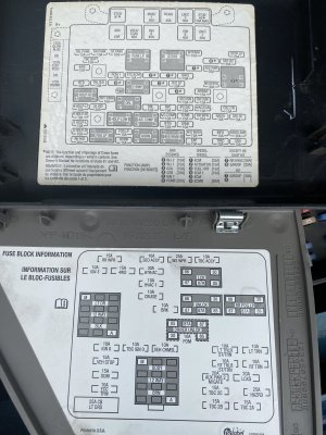

My 06 LT with Autoride junk is completely blown out like Richard Simmons Butthole and want to ****** it out since it’s not serving any purpose at all just dead weight. Obviously I will get a code thrown which I can handle. I plan on ordering 4” rear coils and 2” Spindles And replacing shocks all around.

Yes and the 4 sensors, each wheel has one. You also need to remove the RTD fuse from under the hood.
45,011
Wait- what is RTD, anyway? Shouldn't he be looking for ALC?
*EDIT*
Real Time Damping. It's a 30A fuse. You disconnect the battery, pull the fuse, then hook the battery back up. I assume this is for the AutoRide, which is a different system than the ALC.
