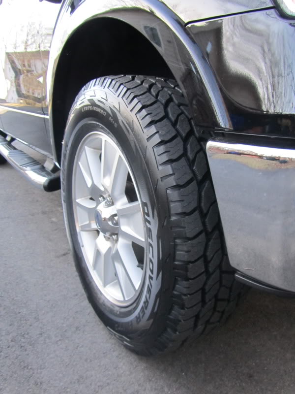

Also other options:
Goodyear Wrangler Duratrac
BFG T/A KO2 (8-ply = HEAVY, right? Poor accel, poor mileage? I don't care about accel rate, I'm not a leadfoot)
Cooper Discoverer ATP
Cooper Discoverer A/T3
Bridgestone Dueler A/T Revo 2
Firestone Destination A/T
Got enough pics there for ya'll? lol Just thought I'd throw some out there, this is the kind of look I am going for. Off-road performance is not overly important, it's pretty rare I am out in the sticks, honestly.

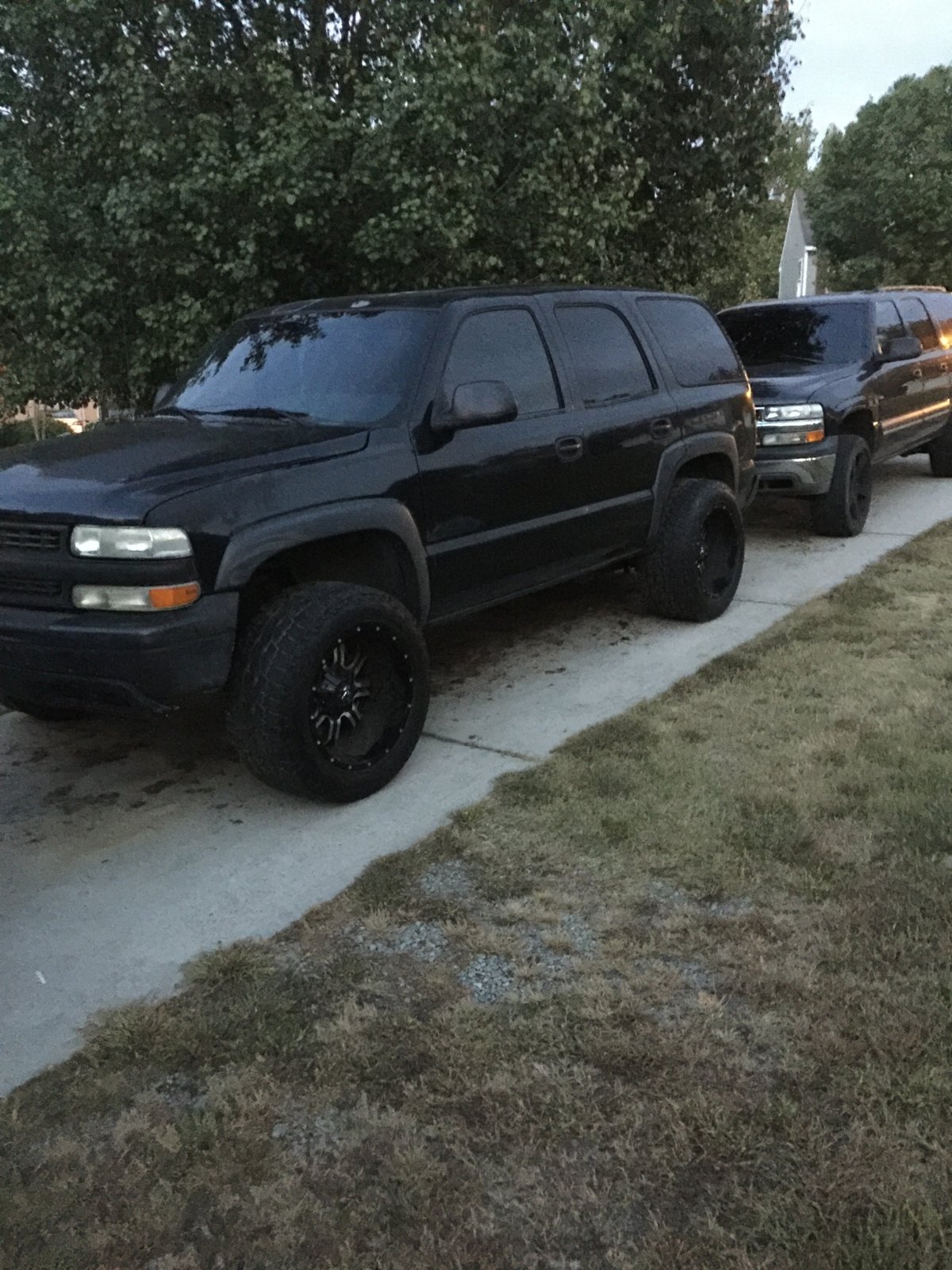

Very happy with my 275/60/20 Falken Wildpeak AT3. Haven't gotten them swapped over to my new wheels yet, but here is a pic of them when they were still on:
