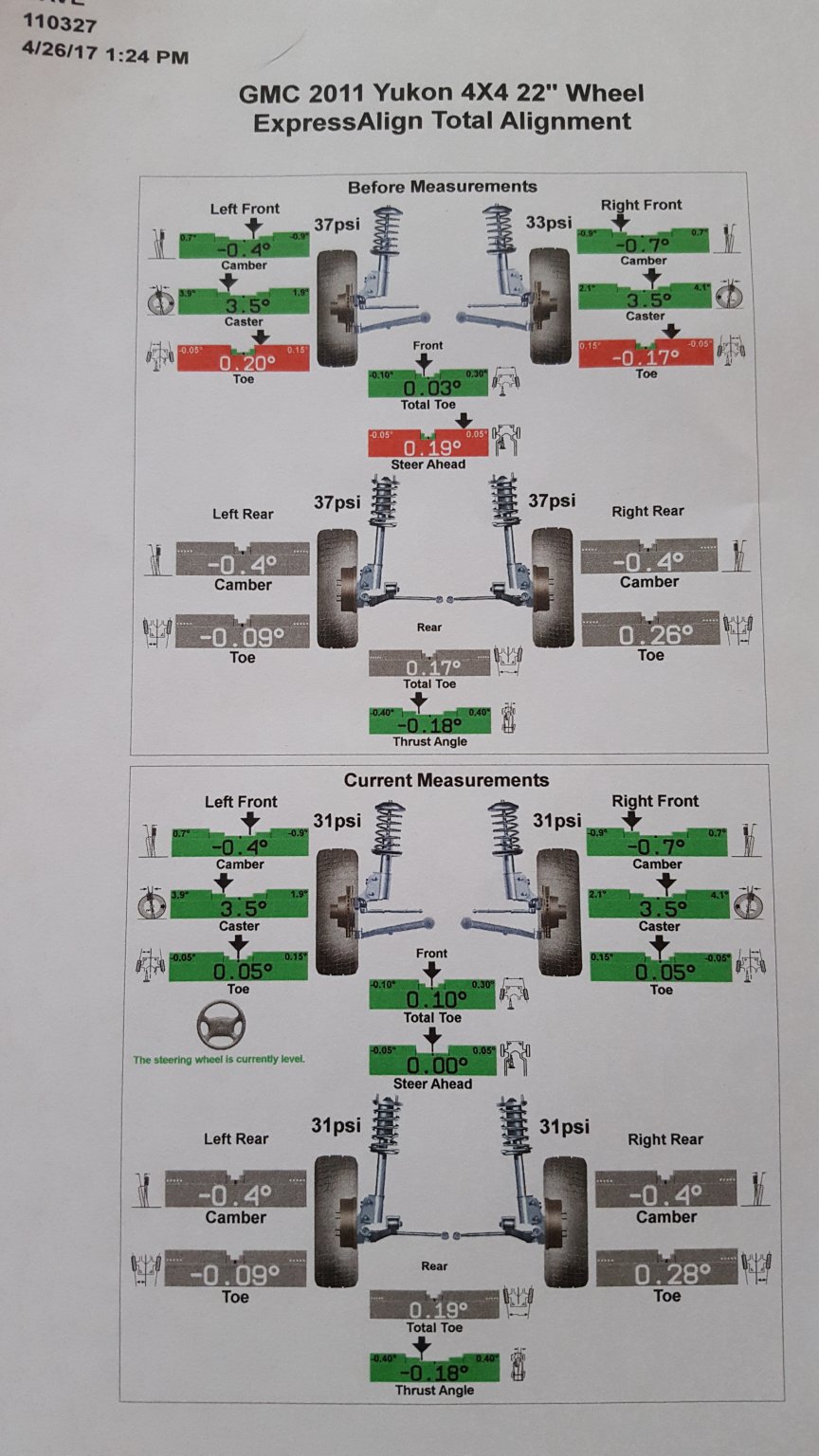

Got an alignment done today and they made a few adjustments. Seems to have made little to no improvement on the steering. The steering itself seems tight but the truck still pulls one way or the other and is very hard to keep driving straight down the road. Doesnt always pull one way sometimes it will be pulling to the left then hit a bump and will start pulling to the right. All the tires have the same psi as well. The steering wheel still shakes a little bit over bumps as well. It's to the point where the wife wants to get rid of it because it's not comfortable to drive any distance the way it is. I don't see how it could be the rims because I had them on my 2011 silverado and my half ton drives normally with them. Any thoughts or suggestions?
