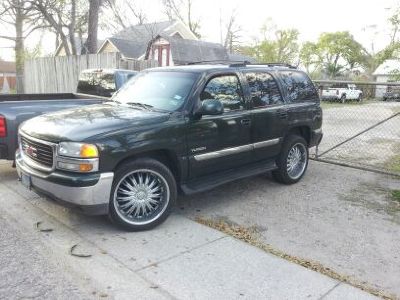

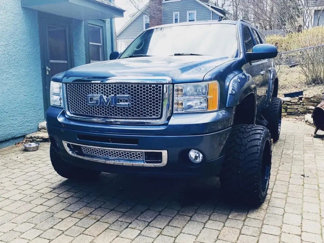

Some examples

That second one I’ve followed. He’s done a ton of work to that truck. Looks fantastic but so few details. At least so far as I’ve found. You can find him on Instagram but very few details.
You just need to make sure that you get everything from firewall to bumper and it will bolt right on. I believe the harness plugs right in and works as well.
I think that’s the 2500 front. Makes sense that all the hard contact points would be the same. Hope that’s right and thanks!
