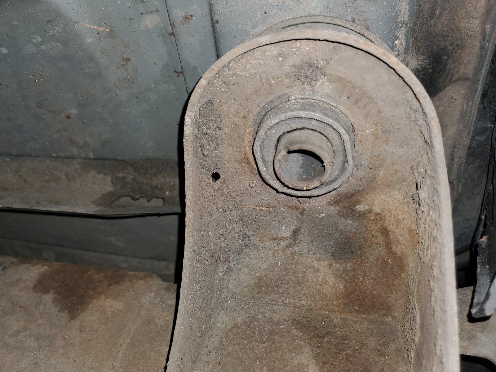

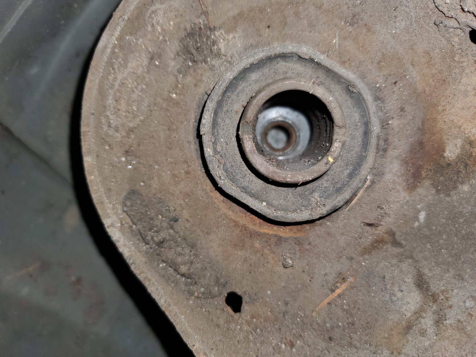

The rubber shock mount is pressed into the frame horn. It is internally threaded and the attaching bolt comes from the top. Look under the carpet.

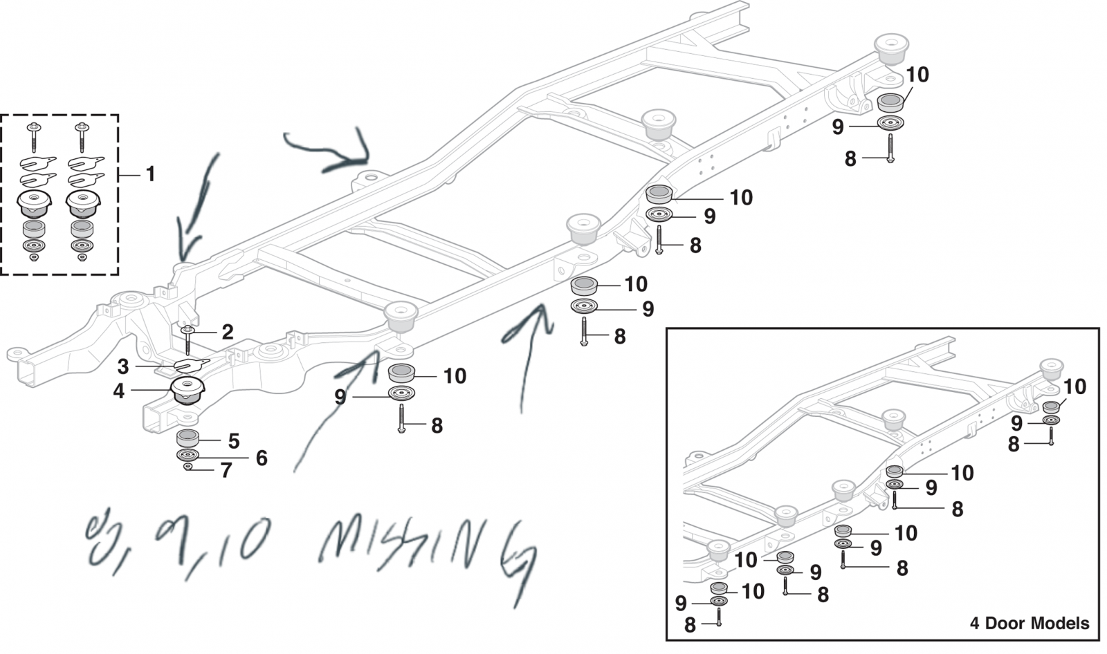

I think he is getting body mounts and bolts. He did not give a count. Plus, I think the one in the pic is broke off inside. I think?
4 or part #9 and 4 of part #10. No broken bolts just not there. I have bolts they came with the running board steps

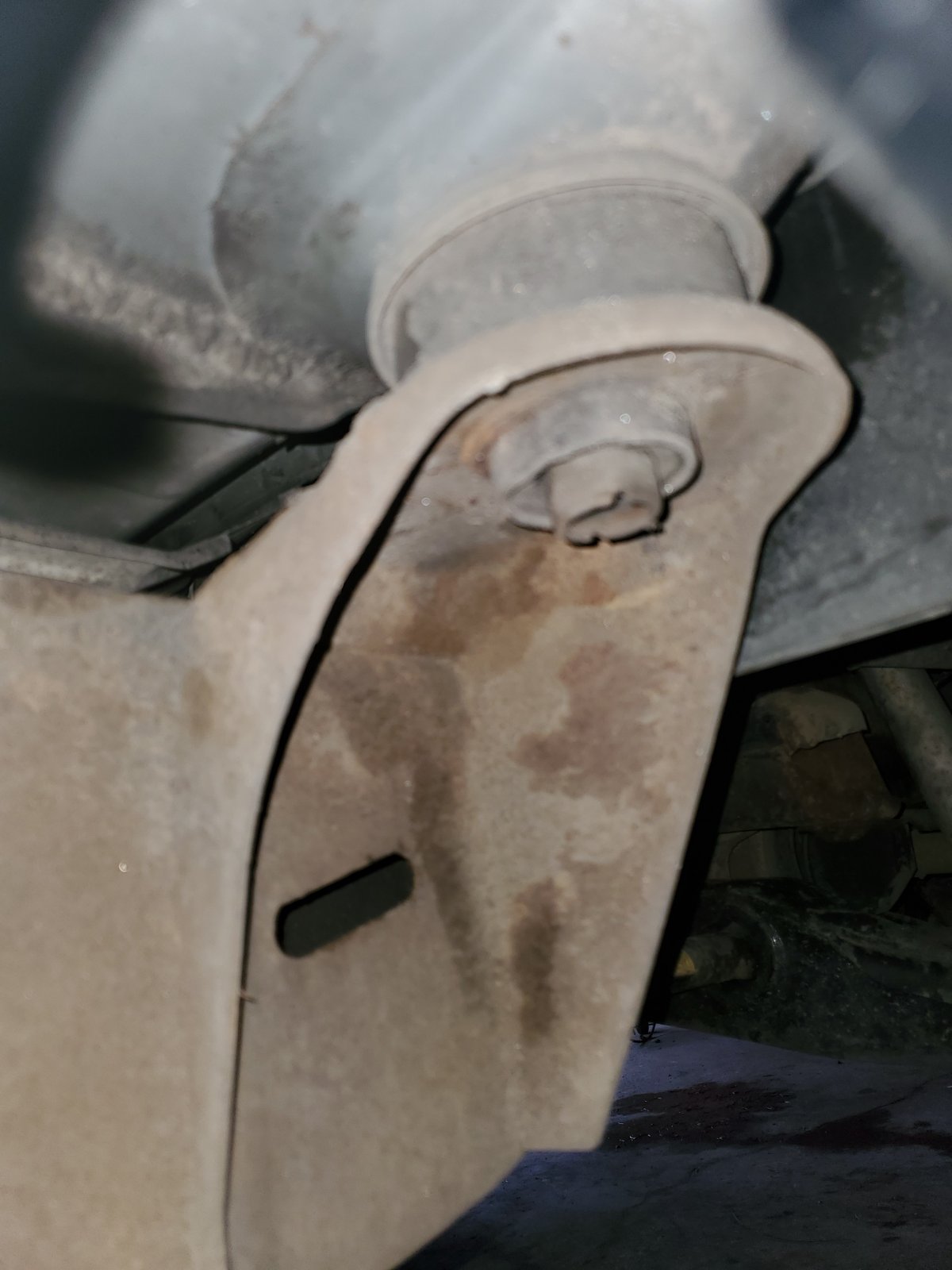

If you look at the pic it looks like the right side bolt in the pic is put in from the top but the left side bolts come in from the bottom. Why? I can understand that if the bolt head is completely exposed, when installed, on the right side that it can come from the top but from the bottom on the left because it would not be exposed. Plus, I don't see a "shock" mount anywhere in the pic. Am I missing something?
Just from looking under mine i can tell you that just the front ones by the radiator bolt from the top
That makes more sense to me. They are exposed from the top. The others would, IMO, come in from the bottom into a captured nut.

It looks like a previous owner had nerf bars that he removed but did not put the bolts back in, or maybe the bars were stolen and nobody thought to crawl under to see if the thief was courteous enough to put the bolts back in :)
Thats exactly what i think happened. Only reasonable explanation
